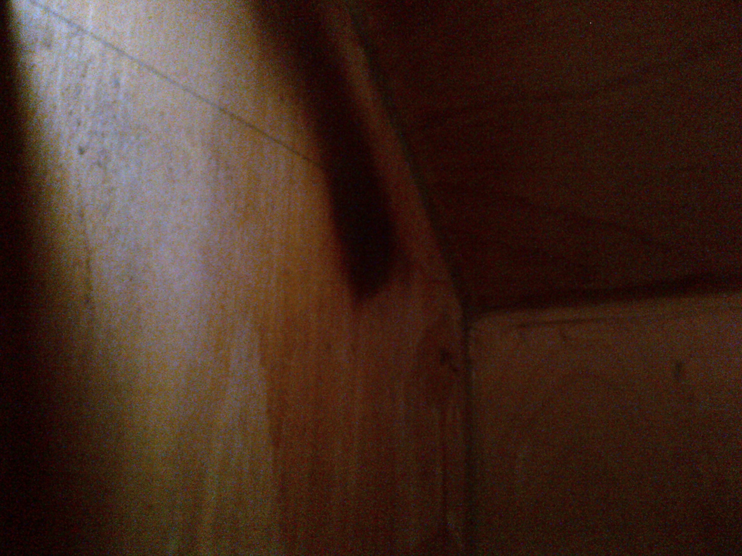

06-27-2013, 22:54
(This post was last modified: 06-27-2013 23:02 by gondolaguy.)
RE: Time to replace crappy Dometic junk absorbtion fridge
(06-27-2013 14:59)Arcticdude Wrote: Corey, Here is where my Dometic now resides on its way to oblivion! Here is why.... |

The doors may need some extra help closing. I know the Dometic will NOT stay closed without the latch. ANY right turn swings it open.
Corey, What was the thing that scorched the wood? I mean I know the reefer, but that's high enough up, there shouldn't have been that much heat. My flame is small enough that it would take a long time of propane burning to get things that hot that high up. John Mace 06 450LXi bigger bird living in the wild hinterlands of the north free to roam without the man getting me down |
06-28-2013, 14:37
(06-28-2013 14:20)Arcticdude Wrote: The doors may need some extra help closing. I know the Dometic will NOT stay closed without the latch. ANY right turn swings it open.The wood was scorched by the propane exhaust, I'm pretty sure. Considering that BlueBird built an airtight case around the Dometic and that there are unregulated openings on top and bottom, I'll bet certain conditions create a pretty updraft that could easily promote overheating despite the basic "throttle" on the propane air inlet. In any case, this is scary stuff considering the limited amount of use my coach has had. That amount of scorching easily could have ignited the plywood and then it would have been off to the races with unlimited air fueling it. |
