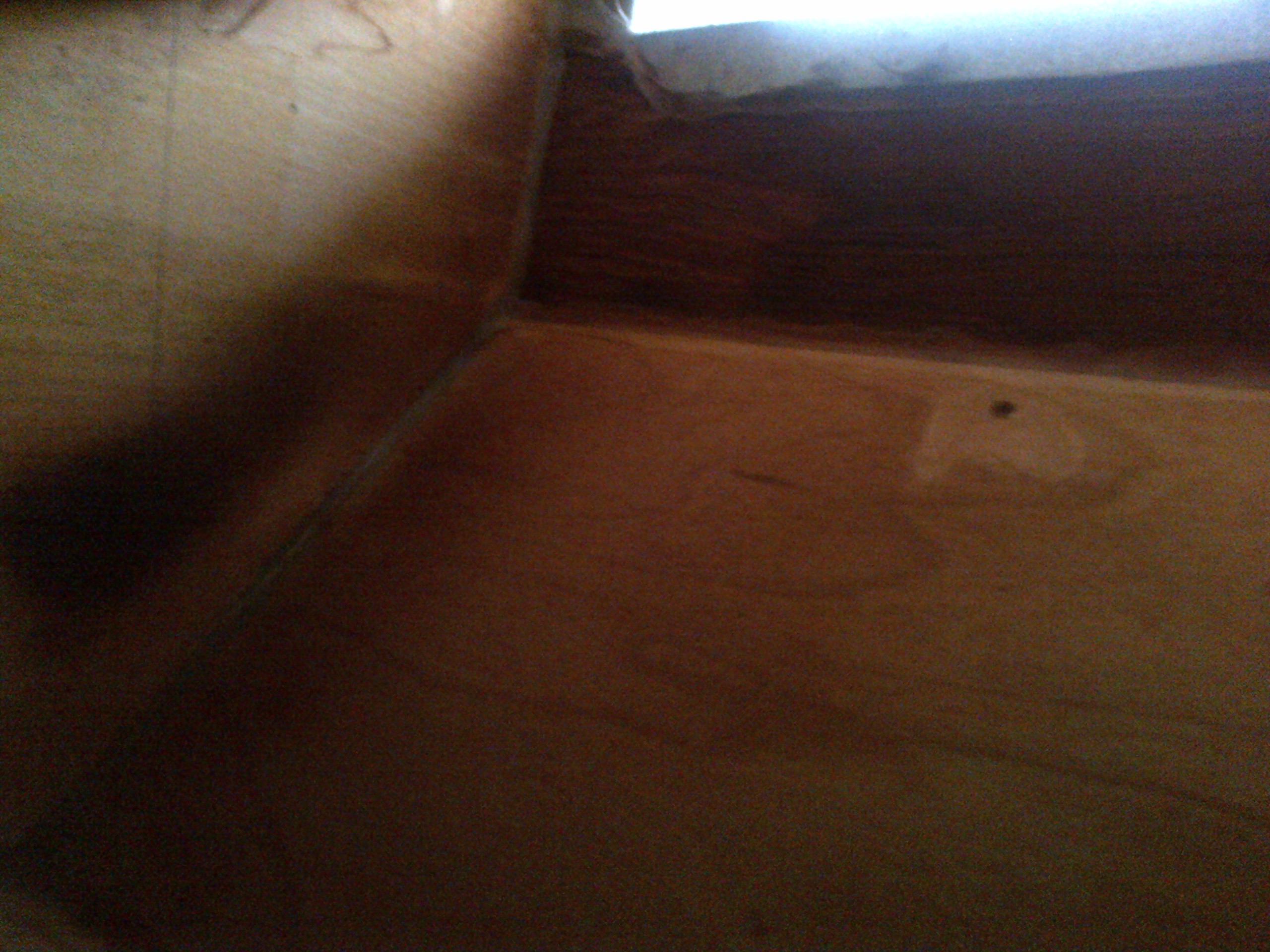

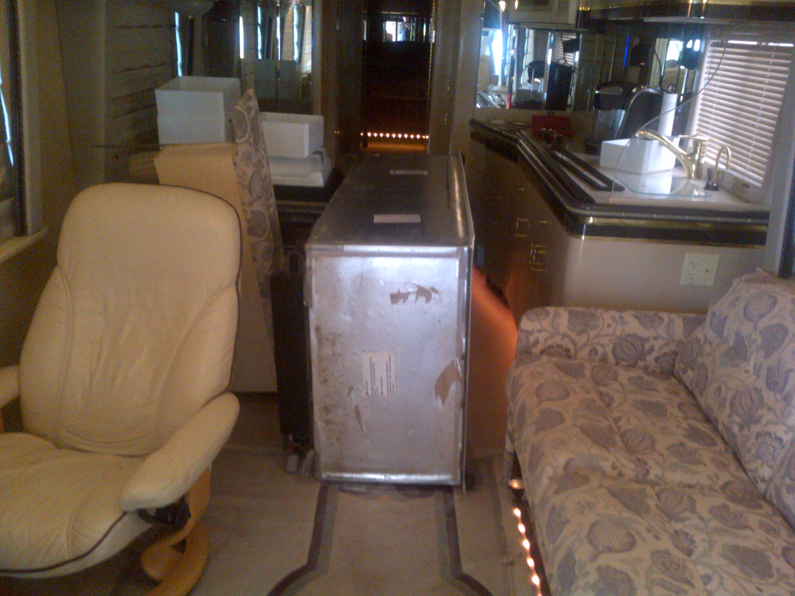

Here is where my Dometic now resides on its way to oblivion! İmage
Here is why.... İmage charred on side of cabinet and top of cabinet on way out of roof vent İmage . Top that off with two electric fans to fuel any fire and a heat sensor at the bottom of the cabinet that would only catch the fire after the roof had melted down!!! This in a coach with 46,000 miles and limited propane use. Yikes!!!

Corey,
What was the thing that scorched the wood? I mean I know the reefer, but that's high enough up, there shouldn't have been that much heat. My flame is small enough that it would take a long time of propane burning to get things that hot that high up.
The wood was scorched by the propane exhaust, I'm pretty sure. Considering that BlueBird built an airtight case around the Dometic and that there are unregulated openings on top and bottom, I'll bet certain conditions create a pretty updraft that could easily promote overheating despite the basic "throttle" on the propane air inlet. In any case, this is scary stuff considering the limited amount of use my coach has had. That amount of scorching easily could have ignited the plywood and then it would have been off to the races with unlimited air fueling it.
