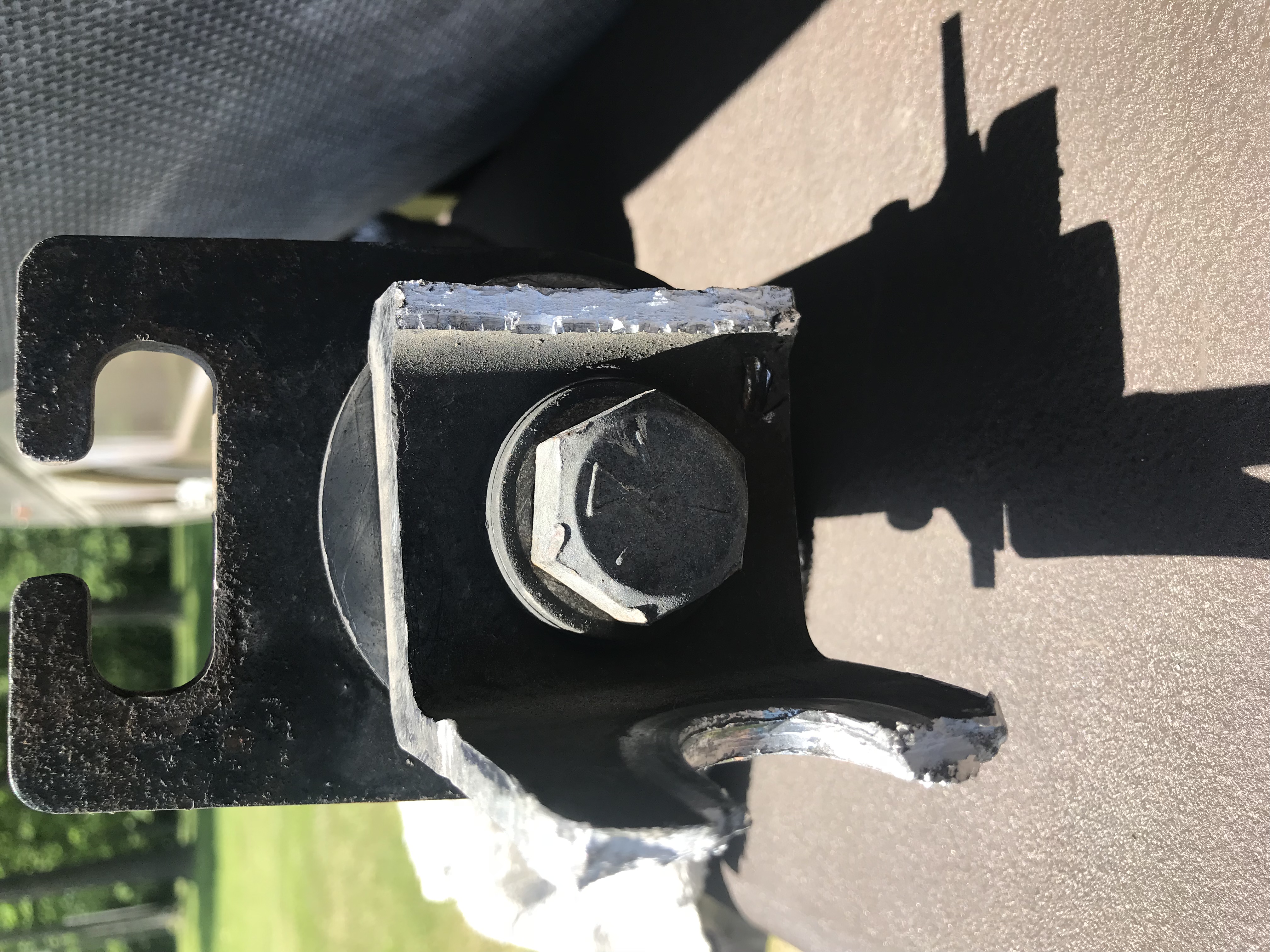

					Just a little more info in response to other posts. Here’s a another picture of the fractired clevis that I had thought was steel. I see no signs of prior fractures in the broken ends. Looks all spontaneous to me.
Yes I had a brand new hitch leveler to make the tow bar eye ball level. Think there weren’t some serious sheer pressures involved? My new receiver leveler tube is now 1/2” from straight over the 6” insertion area. I’ll leave it to David to calculate the forces involved. At least it was steel. If that Blue Ox clevis had been, I don’t think I’d be writing these posts. Still awaiting parts! Mike Bulriss 2001 LXi 43' DS Millennium Edition San Antonio, TX  |

					Have you noticed that Blue Ox changed their design. They no longer let that clevis rotate. Here's one of their new bars: http://www.blueox.com/tow-bars/bx4370bx4...t-tow-bar/. Notice that the rotation about the x-axis (the direction the vehicle is traveling) now occurs at the middle joint. The first joint now has fixed ears welded to the receiver tube. I guess we now know the problem with the old design: one of the ears of the clevis fails, most likely the one that failed at the bolt hole, then the clevis rotates and the other ear breaks in bending. Probably doesn't matter if the clevis is made of steel or T6 aluminum, In this scenario both materials would break. The new design eliminates this. More better!
A quick back of the envelop calculation shows that a 5000 lb vertical force applied 12" away from the bus's receiver would bend that bar. If the bar was solid steel, like the Roadmaster extension, than 7500 lb. So, pretty much the full weight of the toad plus some came down onto that receiver! david brady, '02 Wanderlodge LXi 'Smokey' (Sold), '04 Prevost H3 Vantare 'SpongeBob' "I don't like being wrong, but I really hate being right"  |

I also am done with Blue Ox. Driving home I saw my Dodge Ram 1500 trying to pass my coach. Needless to say when I slowly got everything stopped there was damage to both my truck and the coach. I attached a picture of the clevis. When I contacted Blue Ox they said that only happens when you try to back up a vehicle or make too tight of a turn. I explained to her that I did neither but she insisted that is the only way. Needless to say I am done with Blue Ox. Has anyone had much experience with the Roadmaster tow bars? I think they have a model that will attached to my base plate. Open to suggestions. Thanks Urnie Urnie & Medie Krueger Yorkville, IL 2001 LXi One Slide 1983 FC35 sold  |
