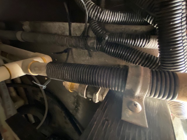

01-28-2021, 14:33 (This post was last modified: 01-28-2021 14:37 by Urnie-Medie.)
RE: Flooded SOB
Hi
Some good news and bad news - Let me first say that this problem developed when I had a AquaHot Service Dealer come to me while I was in Denver area because of the unit not working properly. Apparently the unit froze while he was servicing it.
Below are a couple of pictures of the repair I did at the bottom of the unit. Seems to be OK but will not know for sure until I fix the broken pipe I found at the top of the unit where the water feeds into the distribution manifold. The distribution manifold is connected by two removable fittings (picture attached) that I am having a problem finding.
Hopefully there are no other breaks.
Thanks for any help
Urnie
Sorry all of the pictures die not attached.
Sometimes this stuff is too complicated for the older!!!!

01-29-2021, 01:00
RE: Flooded SOB
Urnie,
Your repairs look pretty good. That’s a clean repair.
Can you find a pex fitting to go into the manifold? You could put a union in the pex and still have the removable functionality of the original. Worst case is to cut the crimp ring and pull the pex off and eliminate the union.
02-11-2021, 00:05
RE: Flooded SOB
Hi
The fitting that connects the water lines to the manifold are available. Just as for a fitting to connect your home hot water heater. The fitting is 3/4 in fip to 3/4" cpvc.
I think I have all the leaks fixed now and will check tomorrow and start putting everything back together
The next time I have someone work on my Aquahot in the winter I will make sure they know that the pipes can freeze and burst in cold weather.
