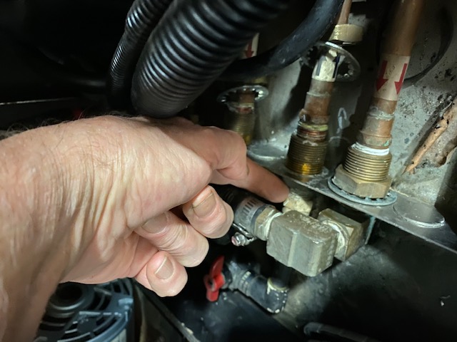

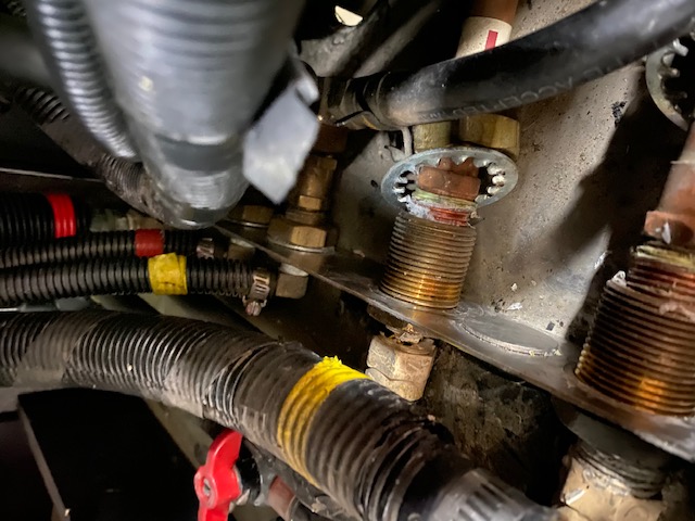

01-06-2021, 15:47 (This post was last modified: 01-06-2021 15:48 by Urnie-Medie.)
RE: Flooded SOB
Hi
I took a couple of pictures. Really not sure how to fix. May have to re-plumb.
Open to any suggestions.
Thanks
Second Picture

01-06-2021, 22:37 (This post was last modified: 01-06-2021 22:40 by Arcticdude.)
RE: Flooded SOB
That’s a very strange break. Did you unscrew the nuts to the right (in the picture) of the star washers? It’s just a pass through fitting for the Aquahot.
If you haven’t already, turn off the breaker to your water heater! It may be too late already. I can’t remember if the element is in fresh water or coolant. If it’s in fresh, it’s probably now bad.
You should be able to unscrew the pipes from the fittings and just replace the fittings. You shouldn’t have to go to Aquahot for them. At least Roger Berke, Rudy Leggett or John Carillo (A-H service folks) should have them, but McMaster-Carr should also have them.
I’d take a really close look at tension on those fittings from the pipes to the left (in the picture). Those fittings should never have broken.
01-07-2021, 00:46
RE: Flooded SOB
Hi John
1- Yes I did unscrew the nuts to the right - this is a "Bulk Head" fitting
2- I hope I turned off the breaker for the hot water heater in time. Hopefully it just heats the coolant. Maybe someone can verify.
3- The broken fitting is plastic- male pipe on the end that goes into the Bulk Head Fitting - Socket - glued on the other end that attaches to plastic. Will have to cut off the broken fitting. As you can see there is very little room.
4- I am thinking that because of how tight everything is I may use pex tubing with crimp on fittings. This should make sure there is no tension on the fittings.
I am open to any suggestions.
