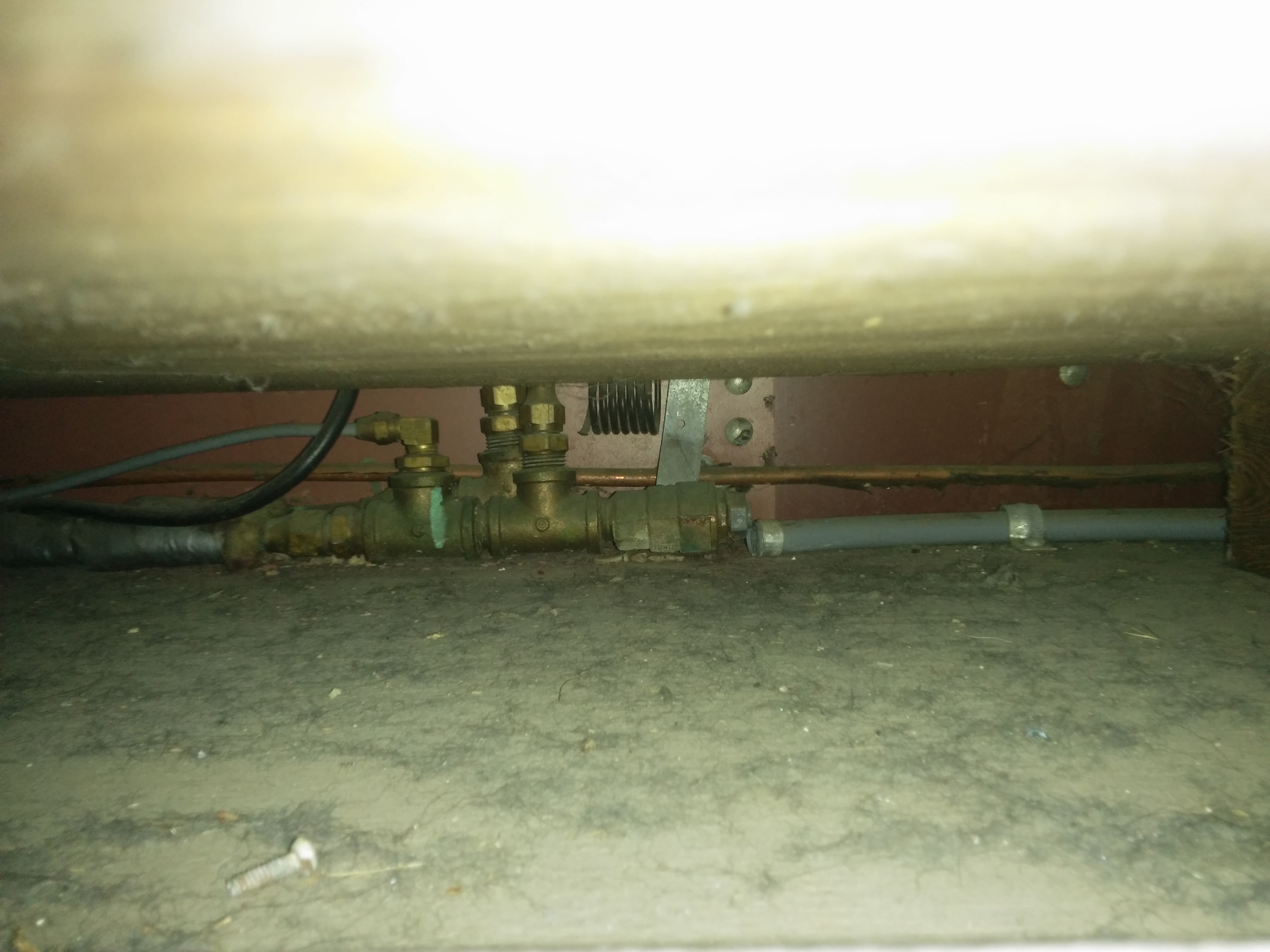

I am set to Summer because of this under the kitchen sink-- İmage and not being certain what would happen from that pipe if I flipped it to winter.. (note for the curious, my ice maker is located tailward from the kitchen, in the pantry area. This hose heads towards the sofa. I don't know of anything that would use water forward of the sink, other than the heater)

There are also two switches (high/low, on/off) mounted next to the engine water heat. Yes I remember those. They control the fans on those chassis heaters, but you will need the winter switch to work to provide hot engine water to them, not to mention making sure that the gate valves in the engine compartment are open. With that pic from under the sink, I'm not thinking that is such a good idea until you get that pipe fixed.
