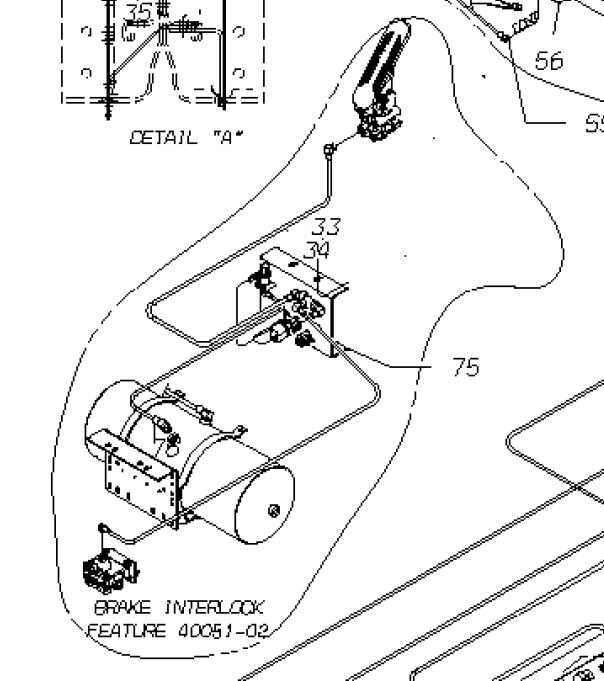

02-15-2014, 18:40
(This post was last modified: 02-15-2014 19:10 by travelite.)
RE: Two questions
(02-13-2014 05:48)ernst Wrote: David, I'd disregard the switch Ernst. On a Blue Bird it's not surprising to find switches that aren't active. The feature could have been removed by a previous owner or it may have been left out of the original Blue Bird Build Sheet with remnants like dash and micro-switches still in place. Attached is a pic of the typical Brake Interlock; number 75 is labeled VALVE ASSY, AIR BRAKE INTERLOCK. I believe the idea is that full brake air pressure is applied when a door is opened. david brady, '02 Wanderlodge LXi 'Smokey' (Sold), '04 Prevost H3 Vantare 'SpongeBob' "I don't like being wrong, but I really hate being right" |
02-15-2014, 19:19
RE: Two questions
Thanks. I think there is a similar device next to the air tanks, but it apparently is disabled. One concern less!
