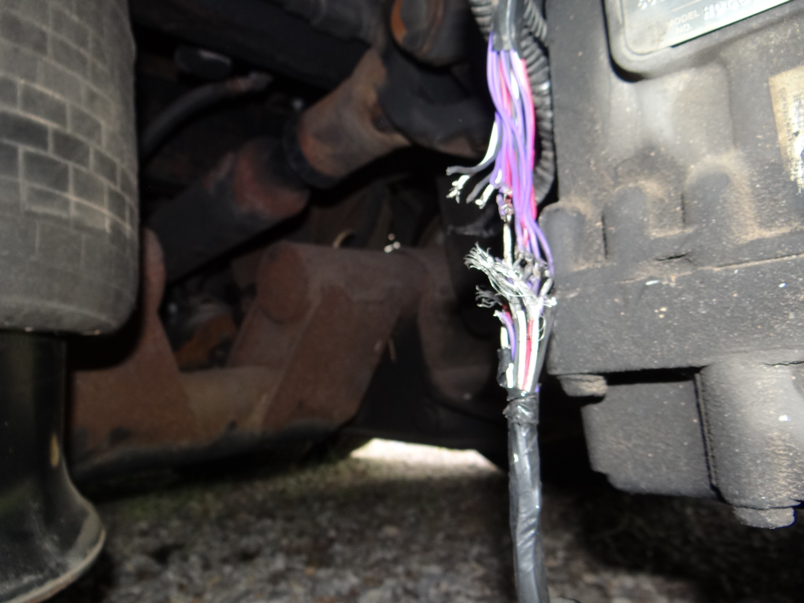

3 batteries in yesterday. went to move coach from front drive to side lot, found out squirrels had eaten the wire loom of the Allison. Got to get that fixed and kill rodents. not good
Bob, if you are a wiring guru or have some thoughts on this I'll be home all day today mess Ernie Ekberg Prevost Liberty Classic XL Weatherford, Tx http://www.ernieekbergflooring.net |

(10-31-2013 08:05)ernie ekberg Wrote: 3 batteries in yesterday. went to move coach from front drive to side lot, found out squirrels had eaten the wire loom of the Allison. Got to get that fixed and kill rodents. not good Wow! Ernie, That is not good! Splicing the wires with butt splices would be the quick & easier way to fix it but I believe I would have Allison replace the whole run of wires. Do you have an Allison service center close by? Do you know if the Allison will shift well enough to drive the bus? Temporarily splicing the wires to get it to an Allicon dealer may be an option but I would definately replace the wires. Chuck Chuck & Tela Millsap 2003 Prevost Marathon XLII 2000 LXi #2 S/S (Sold) 2004 M380 D/S (Sold) 2000 LXi #1 N/S (Sold |

(10-31-2013 08:05)ernie ekberg Wrote: 3 batteries in yesterday. went to move coach from front drive to side lot, found out squirrels had eaten the wire loom of the Allison. Got to get that fixed and kill rodents. not good Ernie, when I had a wiring bundle chafe and short, I used a buss bar with screw terninals in a sealed enclosure to repair it. No butt connectors, plus you can measure each wire with a meter by just removing the cover. I have some nice enclosures about 6 inch square if you haven't got it fixed yet. Bob J. . |

coach was towed to Inland truck in Irving, Tx. Class A facility. Clean, employee owned, I'm impressed. Harness was in stock in Houston, had to ship to Irving.
Lots of wiring had been removed by the now deceased squirrels. And many pieces are yet to be discovered in the squirrel estate nests. Lock and loaded. Ready on the left, ready on the right, ready on the firing line. Commence firing- Ernie Ekberg Prevost Liberty Classic XL Weatherford, Tx http://www.ernieekbergflooring.net |
