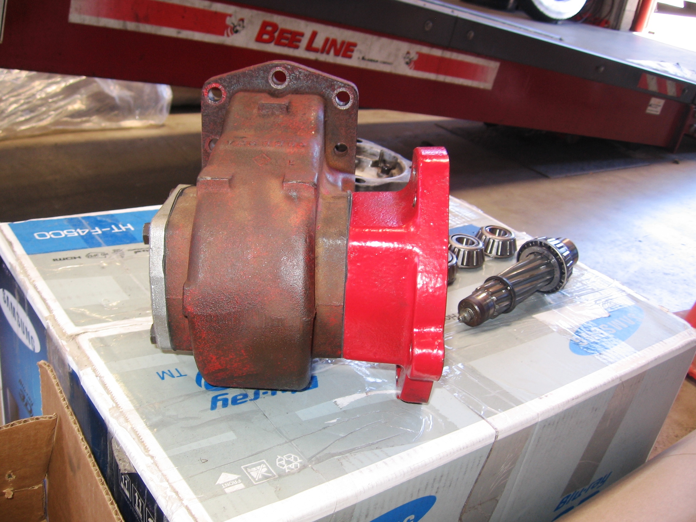

İmage I pulled my pump and checked the splines. Thought you'd like a little more data on wear based on 160,000 miles, with the splines greased every 3-5 thousand miles, using the original grease fitting. The grease however was mostly synthetic, green Tractor Supply (some chassis grease from Detroit techs). No spline grease. The cavity was full of liquid grease, when opened up (it all ran out on the ground), so it was kind of like a wet lube situation.
The attached wear, as near as I could measure from .724 shaft diameter, was about .006". I am going to change to the wet spline, but will run awhile longer, using the Chelsea spline grease (which is in there now).

Morey,
Thanks for the photo and the report. If it were me I'd replace your pump and pto splines sooner than later. Your photo shows significant wear on the face of each spline. Once the wear progresses thru the hardened outer layer it'll accelerate. It won't take long to chew thru the remainder of the spline width. The wear on the face of the spline looks like it's blued from heat. The heat also does a number to the temper of the steel. IOWs, the material remaining might be significantly softer than what was initially spec-ed.

Morey,
As the splines wear the PTO will become more noisy. If you are experiencing a noticable increase in noise coming from the PTO while running, it may be time to replace it. Loaded with grease may deaden the whine somewhat. Johnney Anderson told me that too much grease there is not good. If I remember correctly, he said 3 to 4 pumpe of a grease gun (special grease) is adequate at each oil change.
