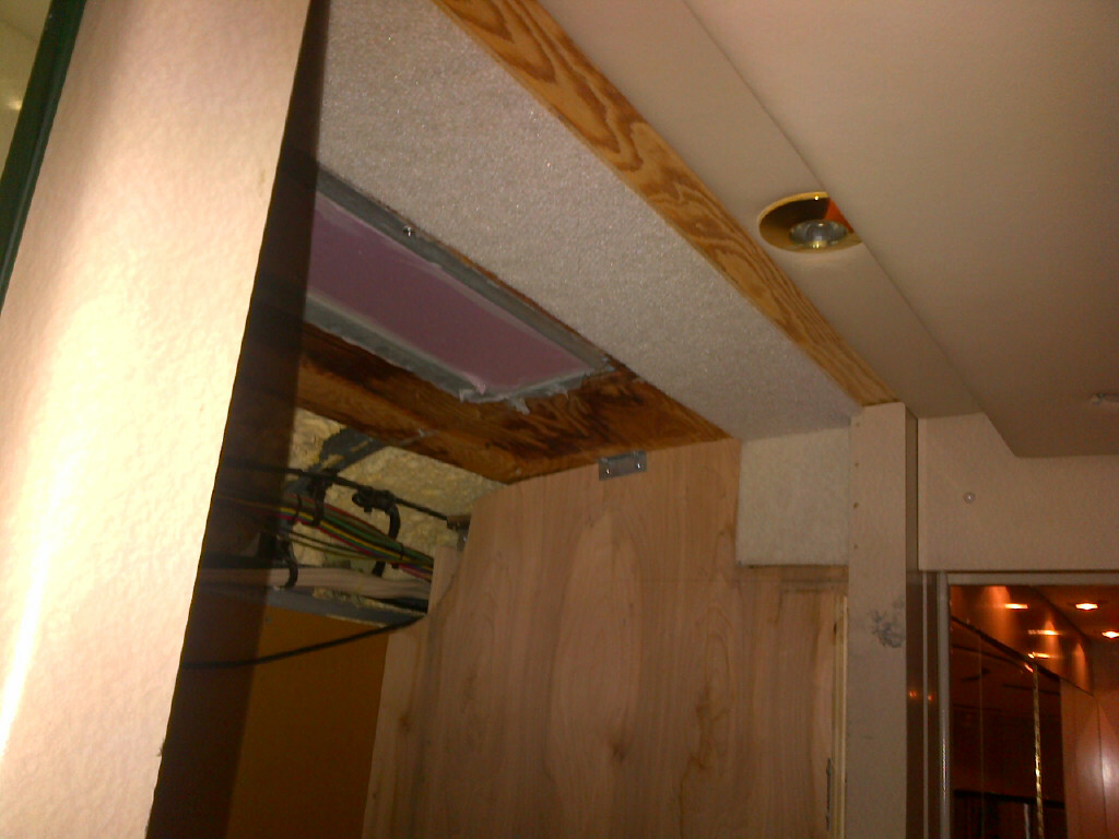

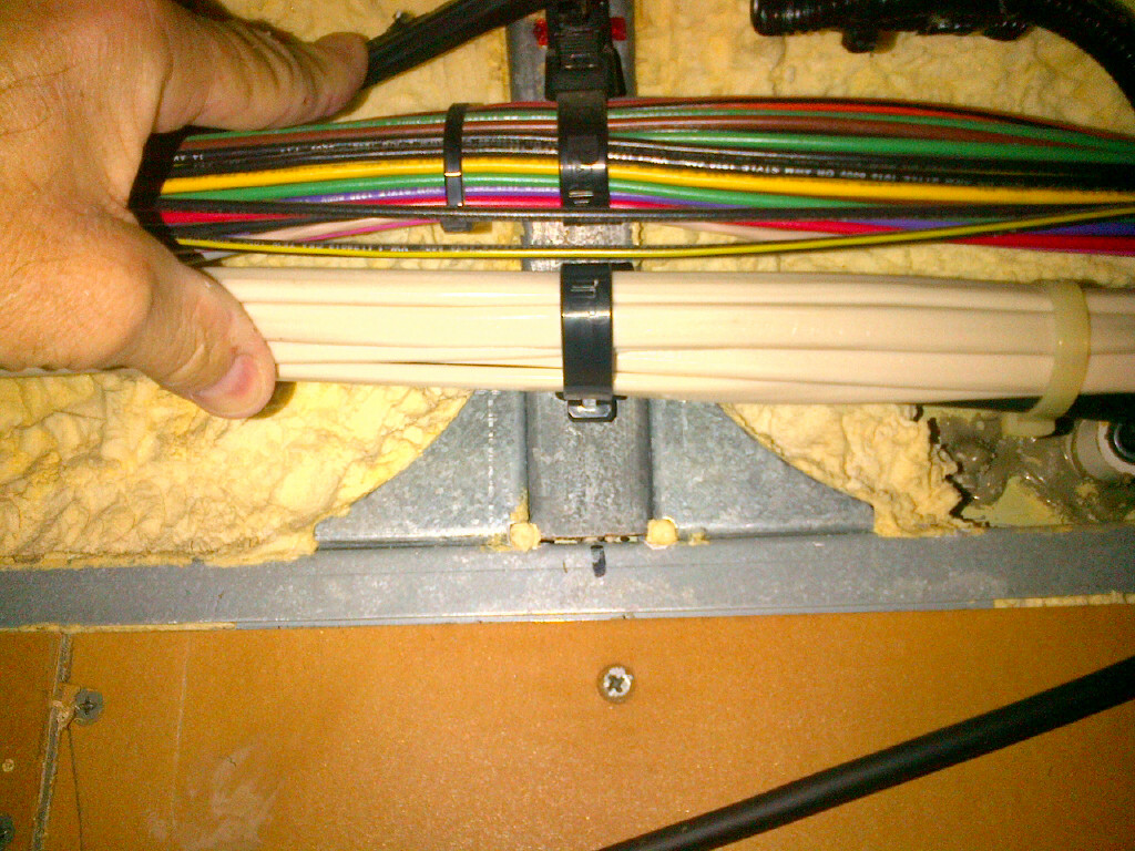

(07-05-2013 18:38)gondolaguy Wrote:(07-05-2013 18:01)davidmbrady Wrote: Corey, David, Here is a better view of the top cabinet removed. am assuming your AC/roof drop panel is similar. My bottom drawer measures 10" high X 32.5" wide (this is staying for my application). The entire box above the drawer (so add the drawer height back if you want) is 68" to the A/C panel or 70" to the roof. These measurements are with the top little cabinet removed. As you will see by these photos, the bracketry for my non-slide equipped (limited edition) coach is pretty straight forward and adds no further stand-off from the wall. I may elect to ties those wire bundles up higher. |

(07-08-2013 13:44)gondolaguy Wrote: My bottom drawer measures 10" high X 32.5" wide (this is staying for my application). The entire box above the drawer (so add the drawer height back if you want) is 68" to the A/C panel or 70" to the roof. Thanks Corey, The quarter round extruded aluminum roof beam on mine looks like the one used in the M380 and M450. Here it is: Thanks for the refrigerator compartment height measurements. I'll be at my bus in a couple of days so I'll be able to take a first hand look, but from your measurements I should have approximately 78" from floor to AC drop ceiling. I checked into the Sub-Zero 700 Series refrigerator specs; you know, the one used in Prevost conversions and Newells??? They make a 700 series that will fit width wise but they all top out at 80 inches, so I guess I'll have to rule out keeping up with the Jones's! I'm thinking, pending any definitive word on the Amish Cooling Unit build and materials quality, and considering that I have a growing family of five, that I may need to trade off energy efficiency for size! I need to feed five! LOL It's interesting all the different requirements we have. Some owners never step foot in a campground and when away from home are always on genny or batteries or gas; some owners require that their residential fridge consume miniscule amounts of electrical power so that they can survive on their aging, sprinkler fed, singular flooded lead acid battery; some owners need to feed a family of five and interior fridge space trumps all! Customization is the bane and bread and butter of the motor coach industry. david brady, '02 Wanderlodge LXi 'Smokey' (Sold), '04 Prevost H3 Vantare 'SpongeBob' "I don't like being wrong, but I really hate being right" |
