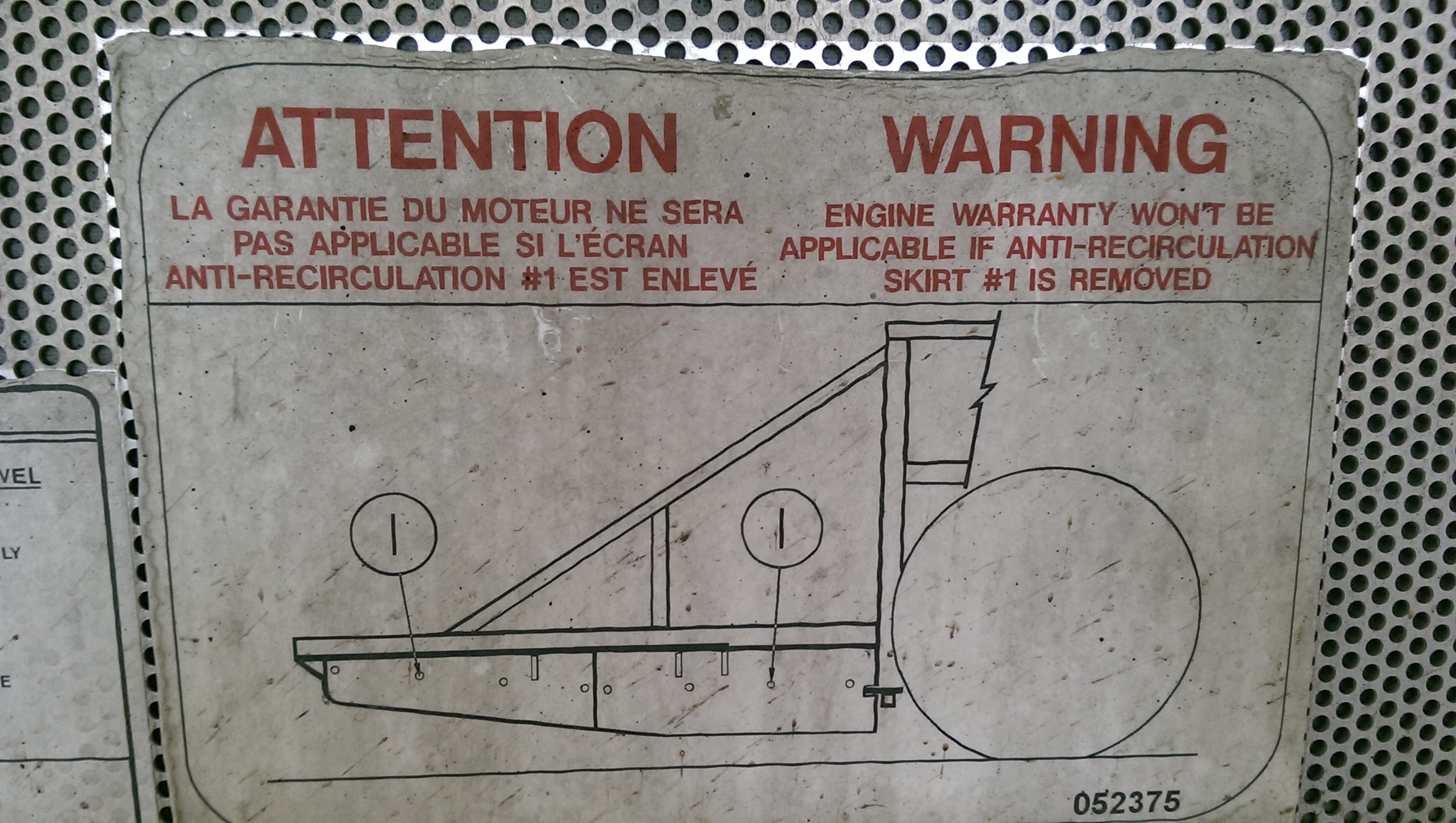

On a Prevost H3 that I've been looking at, I found this placard pasted to the engine compartment.
Loading...
