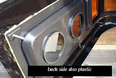

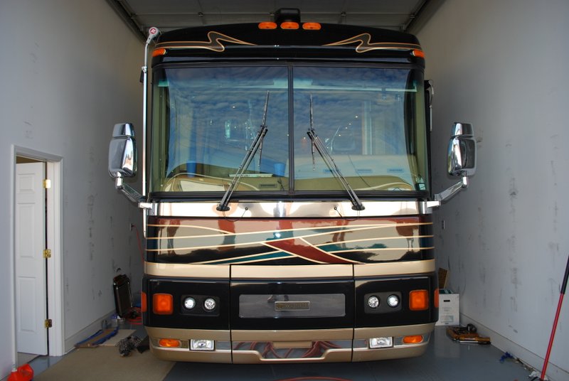

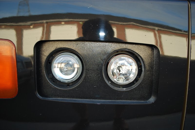

Here's pics of the lexan cover, front and back. They're fastened on to the bus bumper with those long studs with t-bolts from behind the bumper. Sounds llike you got this far. Once you have the lexan removed then you'll see the 120mm headlamp units and the mounting brackets used to fasten them to the bumper. I pulled off the entire assemblies and replaced them with 90mm Xenon HID's using a universal mounting kit bracket from rallylights.com:
I ran separate wire for the Xenon HIDs, but Xenons typically uses less power than Halogens so your stock wiring should be okay. It's been a while but I seem to recall the nuts holding the housing brackets to the bumper are captive. Unless one breaks loose you shouldn't need to get behind them. david brady, '02 Wanderlodge LXi 'Smokey' (Sold), '04 Prevost H3 Vantare 'SpongeBob' "I don't like being wrong, but I really hate being right" |
