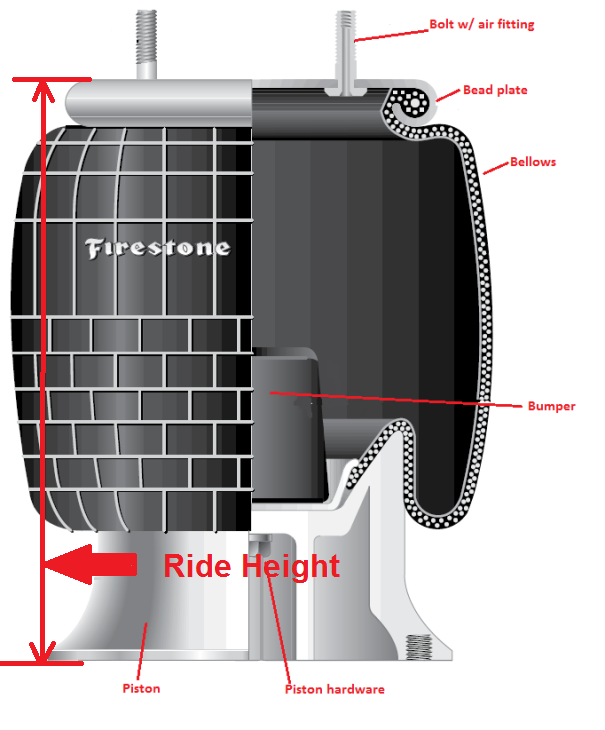

The spec is 8" +- 3/16" for both the steer and the drive axle air springs.
You measure the complete spring, from the bottom face of the piston to the top of the bead plate. I'll see if I can dig up a picture.
The location of the height control valves and their adjustable shafts should be plainly visible when you craw under the coach. The front HCV is at the center of the stick axle and the two drive axle HCV's are to the forward and outer sides of the drive axle.
