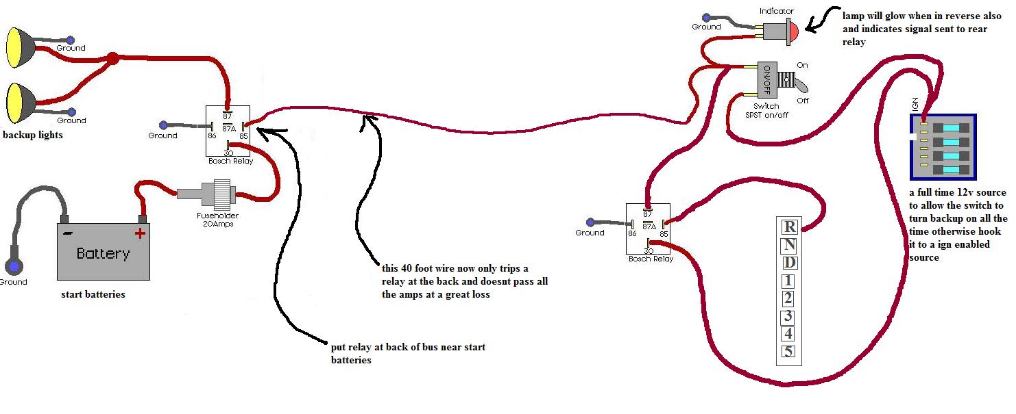

problem is now they will not come on automatically when you prompt "R". If you
take the wire you taped and stuffed, make that wire power a relay (norm no
contact) find a +12v source to pass tie it into the light side of your switch,
there will be no back flow to the trans buttons when you manual power the
lights.

I dont know how to add an attachemnt??? here is a photo link of a paint diagram
of what I suggest
http://groups.yahoo.com/group/Wanderlodg...13126\
69/view?picmode=&mode=tn&order=ordinal&start=1&count=20&dir=asc

10-11-2009, 15:57
Rear Parking Lights
Below is the pic of the relay set up that will allow you to keep the automatic backup lights on and also give you the option to turn them on manualy. even if you have the man switch off , the shifter will turn them on. in the diagram below the line from the cockpit to the rear of the bus is used only to trip an additional relay at the back but you can keep it to power the lights.
you can also add one more relay after the R trans signal wire to turn on the rear vision camera. that also would be wired on the other side of the man switch for the camera. I can add it to the diagram if needed
if this image is too big here is a link to one hosted on my site
http://www.rainbowrv.com/images/backuplts.jpg
