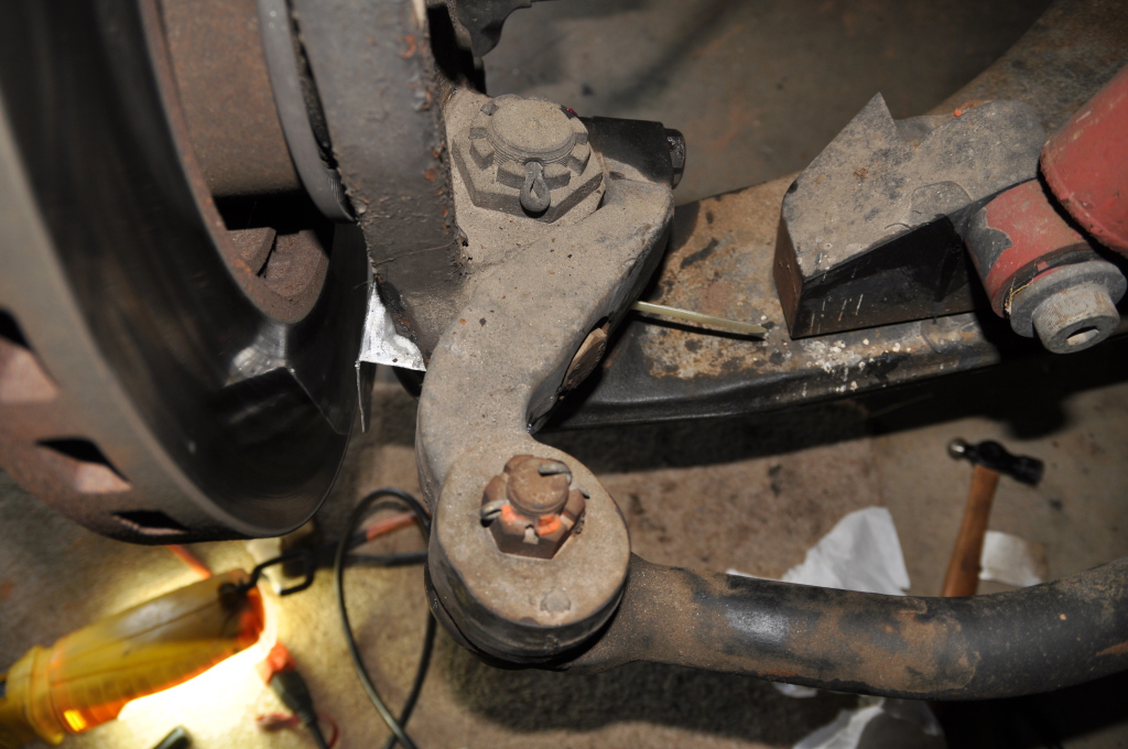

If you install a new boot consider a heat shield.
A few suspensions had a heat shield for the boot. Ed and I made one up from aluminum. Glued it to the A frame. Not fancy , but still there after 2 years. Sorry, poor pix. Looking for a better one and a sketch.
