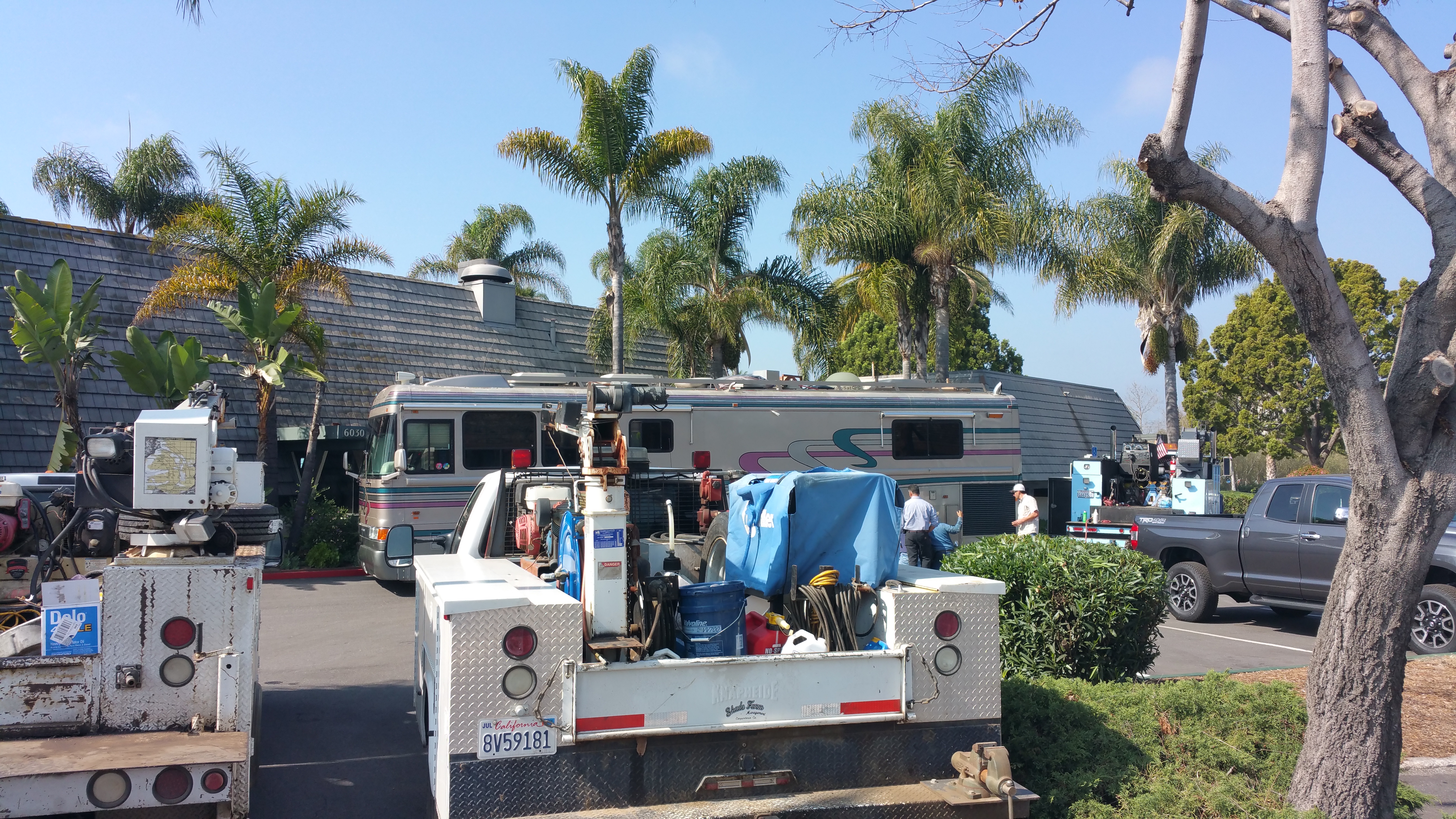

					it looked like all is well with the axle and bearings but two of the inner bearing rollers were cracked but still in the  set retainer.  I decided to replace all bearings, shoes ,seals and hardware.

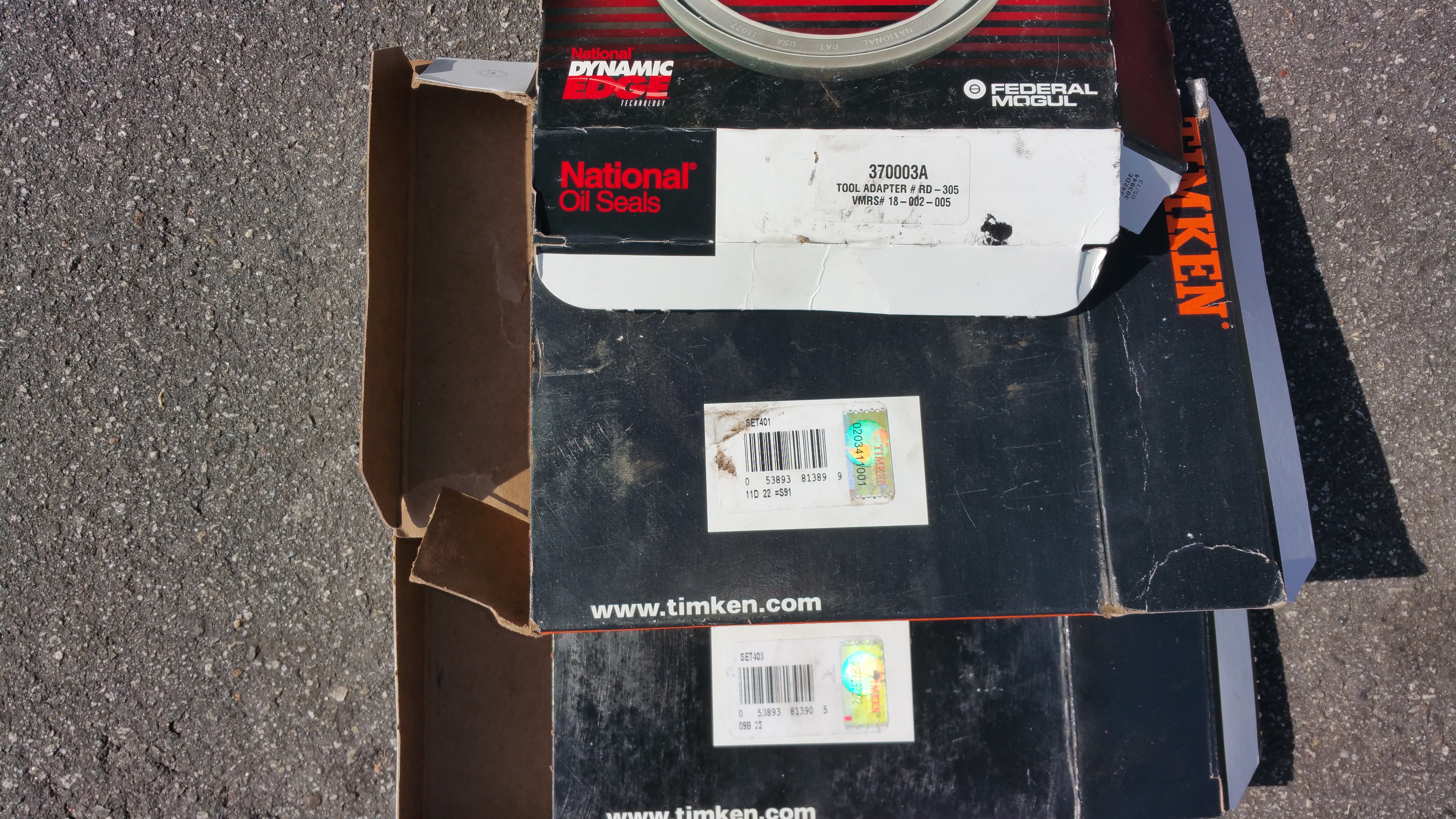

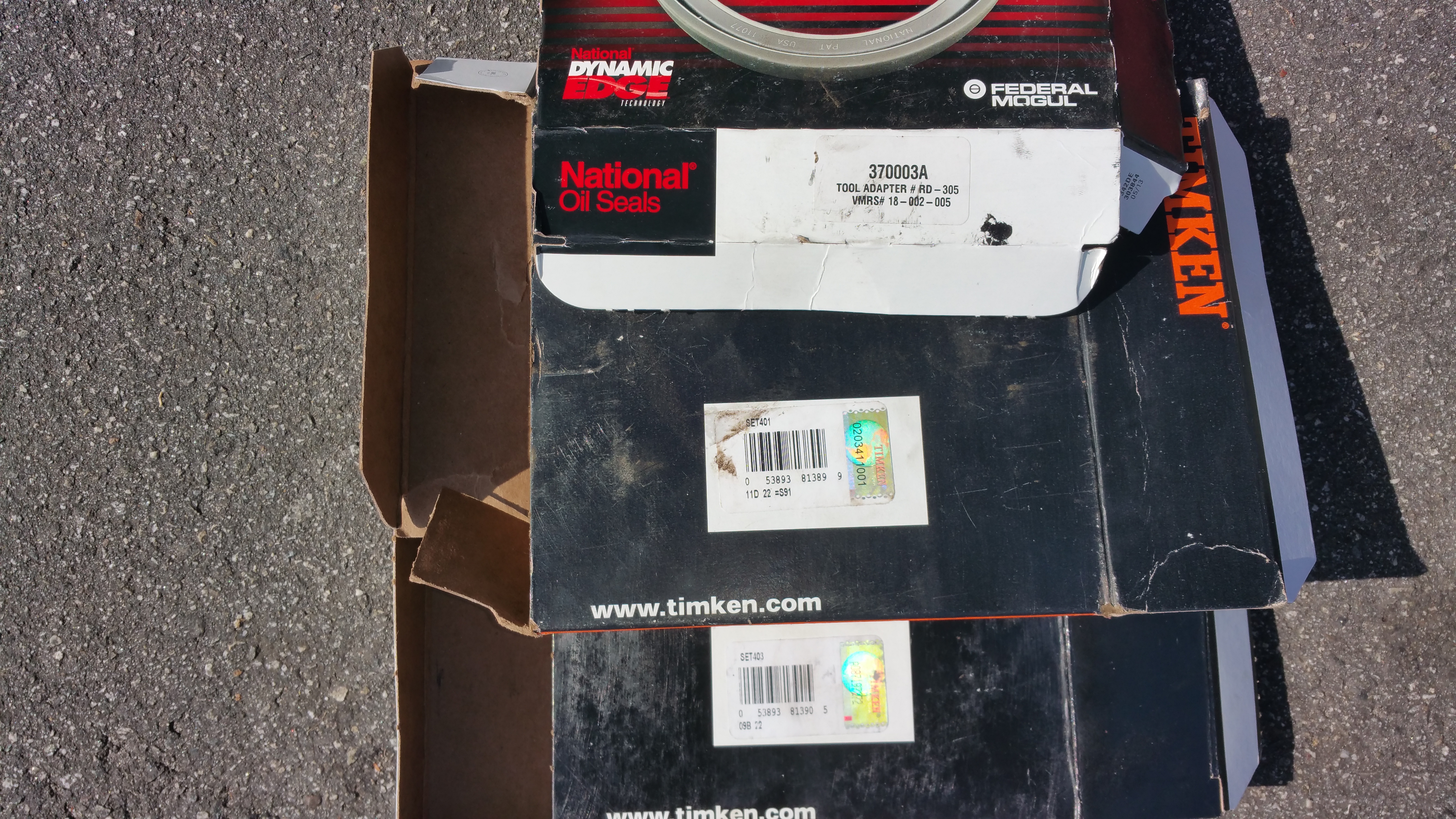

Parts source Coast Truck Parts Ventura, CA 805-656-8709 Bearing Timkin TI set 403 Mile-Mate 594A/592A Bearing Timkin TI set 401 Mile-Mate 580/572 Inner seal FE 370003A Brake shoes classix6-C1 EX Q Brake Kit EB E2769HD Parts were less than 300. drum clean up was 45.00 labor 600. while we ran for parts the tech removed oil from the other three baths and replaced with new and a stabilizer. He also dropped the drive axle fluid and replaced and lubed some of the chassis in the rear. The Tech is Juan O's Mobile Repair of Ventura. cell 1-805-570-3071 office 805-689-3122 another tech that I found in the area was Tim Parks cell is 805-331-2815 . When they quoted rates for an rv I told them to pretend it is a dump-truck with awnings. rate for dumptrucks is 100. hr no setup rounded up to the hour Gregory O'Connor 2001 LXi43ss Romoland California 92585 951-830-5997 Rainbowrv.com  |

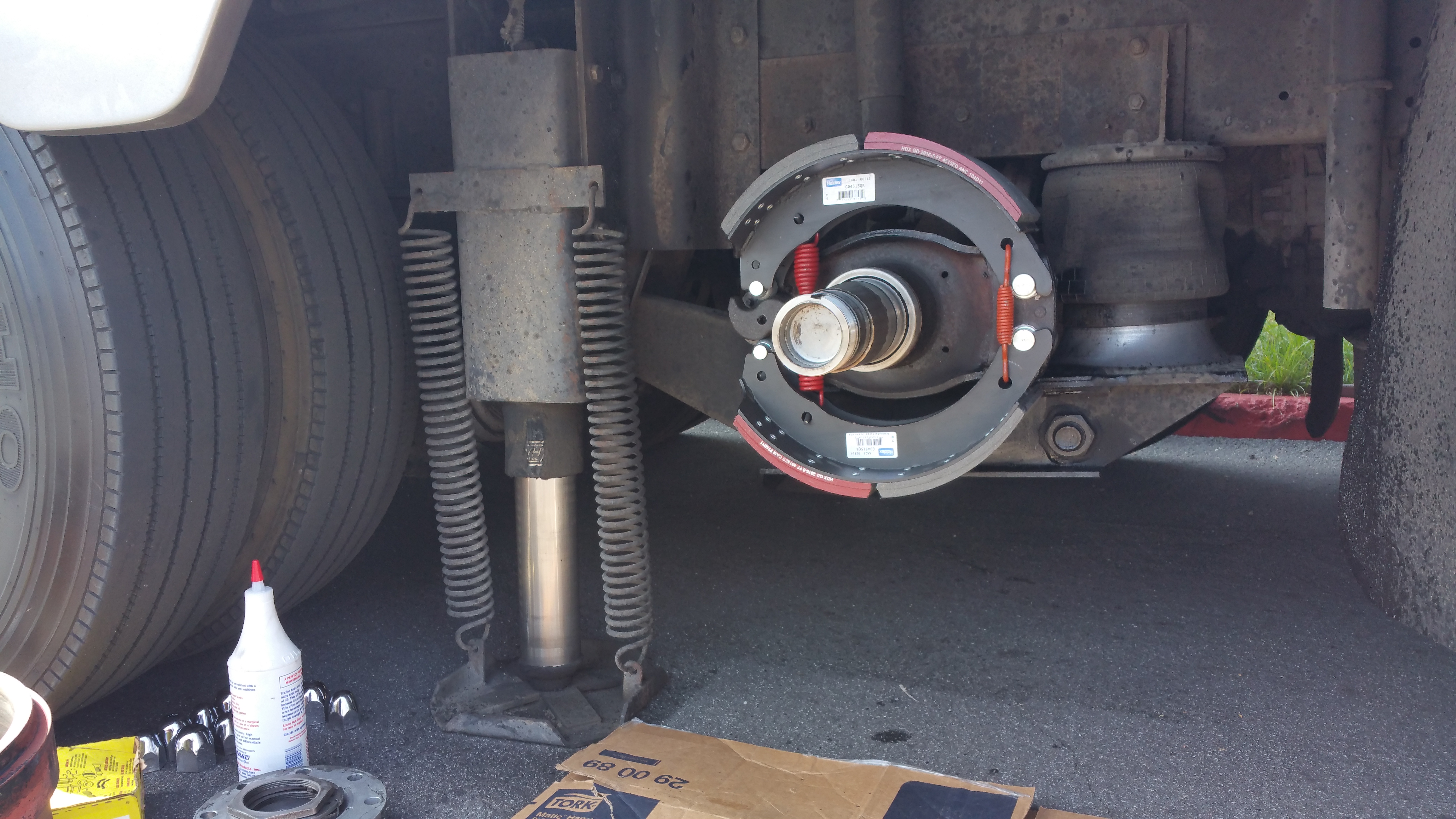

image of bearing and seal box show's number that are listed in prior post Image of axle, please note the shoulder that the seal race rides on has a cavity under it that needs to be cleaned out with solvent and air pressure to remove metal and grit that otherwise will screw the new bearing sets. I ended up with three mobile techs onsite by the time the job was complete. They sent over an opacity computer for me to do some PSI tests when they learned I was certified. Seems no one in the county has the cert. some images of the repair image of bearing and seal box show's number that are listed in prior post Image of axle, please note the shoulder that the seal race rides on has a cavity under it that needs to be cleaned out with solvent and air pressure to remove metal and grit that otherwise will screw the new bearing sets. I ended up with three mobile techs onsite by the time the job was complete. They sent over an opacity computer for me to do some PSI tests when they learned I was certified. Seems no one in the county has the cert. To view image in the largest stored size, From Firefox, left click on the thumbnail >Right click on the shadowbox image > chose 'view image' by left click > when it opens, then left click again on the + magnifying glass Gregory O'Connor 2001 LXi43ss Romoland California 92585 951-830-5997 Rainbowrv.com  |
