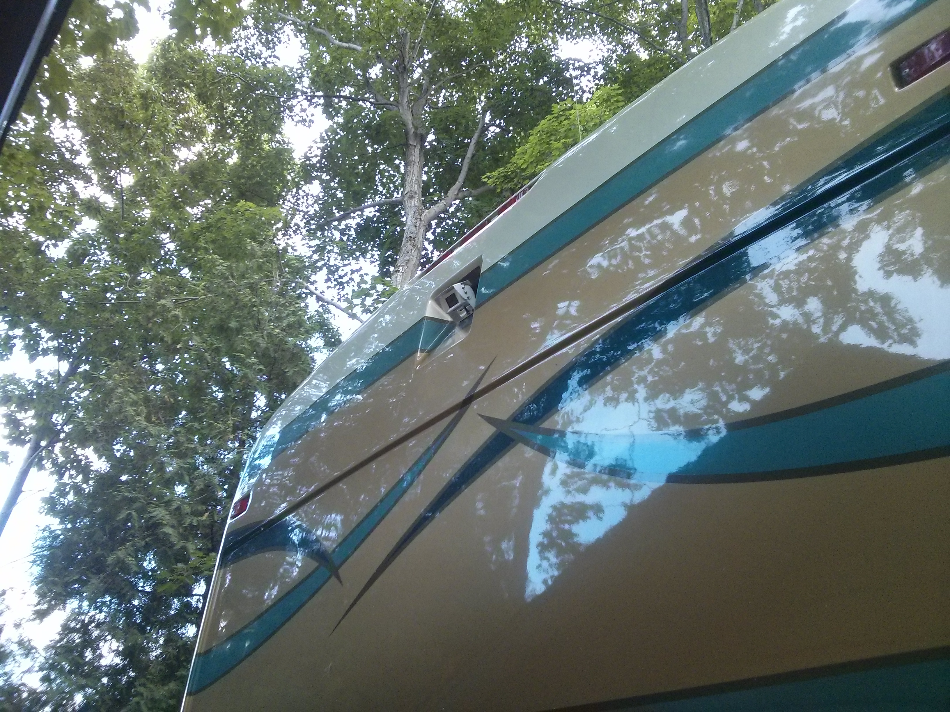

I have replaced the rear camera on the 450 using the same cable and Panasonic monitor.
The original camera was a MITO ecx 100. A double camera with B/W and colour. It is no longer made.
I spoke with a very helpful rep at Mito corp who suggested using an adapter that they have available with the Mito CM 32
http://mito-oem.com/product.php?id=CM32AH
The adapter requires 4 soldered connections that can be done on a bench. Then a simple plug in.
I mounted the camera behind the glass but the IR caused double reflection so I had to mount it outside, drilling a 5/8 hole in the FG under the old glass. Drill the hole off centre to give the wire some room to allow tipping. The unit comes with a grommet. It was made for metal but it works with touch of adhesive -- unlikely that it would come out anyway.
Cost about $140
Picture of camera installed.
