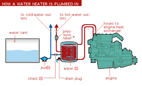

wow you are the first to not call it a hot-water heater. I'll go with Chuck but add that an inlet restriction would be possible also. The other thing that may be a long shot, and I am not sure if it is possible to mix up,, but if you are using the engine heat exchange ,,,did you hook the potable-fresh in and out to the storage tank? or in error to the radiator fluid path?
both paths are continuous and independent but the potable fresh water path has the larger storage and the blow off valve. You may understand all this but I for one was surprised that the engine heated the water heater tank while the bus was running down the road Gregory O'Connor 2001 LXi43ss Romoland California 92585 951-830-5997 Rainbowrv.com |

Make sure you re-installed the check valve the correct way.

(12-31-2014 16:07)cheryltiemens Wrote: !st time using this forum. If you are sure you have all the lines hooked back up correctly, then I see a different issue. Hammer noise? Sounds like the plumbing is air bound to me. Same thing happened on my 91 after I changed out the shower mixer valve. A buddy had a similar occurrence on his 89 and clued me on it. To get the air out of the line, make sure the pump is on and go outside and open the drain line in the black water tank compartment. While that is going, come back in and start opening faucets. Worked for me (and my friend that clued me in on it). Good luck and let us know what you find. Oh, and welcome to the forum! Mike Bulriss 2001 LXi43 DS San Antonio, TX |

Water hammer and trapped air is a big problem. I leave my pump on all the time even when it is stored. To keep from opening a valve and running air in the system. One of the issues many folks have is with icemakers that continue to ask for water and when there is no pump pressure, the valve soon allows air to enter the ice maker line. That light duty plastic air filled line ends up blowing apart when the air in it is hit and compressed by a column of water when the pump or city water is later turned on.
The water hammer-bang happens when rushing water is abruptly stopped. incomming water continues to pack the line and compress air if it is in the line. With air in a line you can pack several hundred psi of momentary pressure even if you have a hose bib pressure regulator. Once the column of water maxes out the compression stroke, the air forces the water back in a power stroke. Sometimes it goes back and forth. eventually the entire plumbing system will have greater psi than that delivered. To get air out of the line you need to open every lateral line and fill it with water. Ice maker seem to be one of the last to get water filled up and the first to sneak air in. Gregory O'Connor 2001 LXi43ss Romoland California 92585 951-830-5997 Rainbowrv.com |
