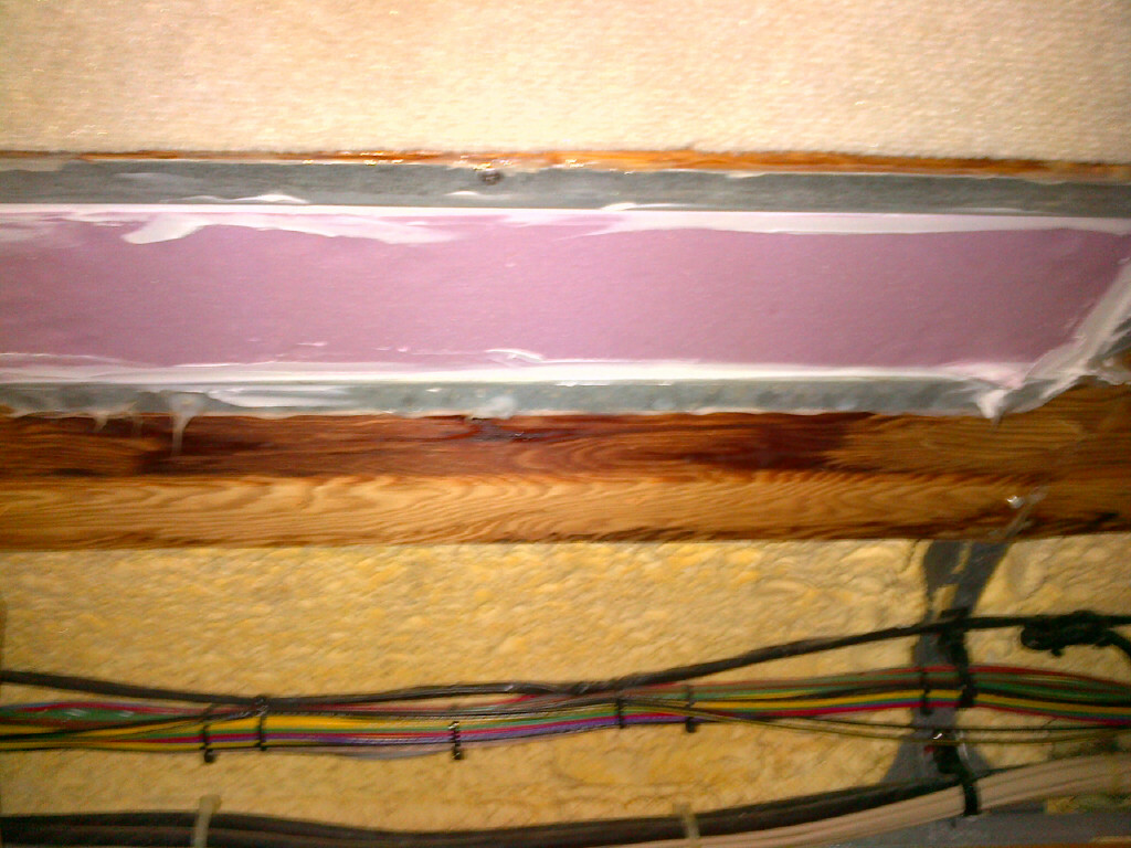

![]() So, up north Lowes ruled king, but here in Hendersonville Home Depot is 5 times better stocked. Luckily found foam in 2X2 form so I didn't need to deal with 4X8 ![]() |

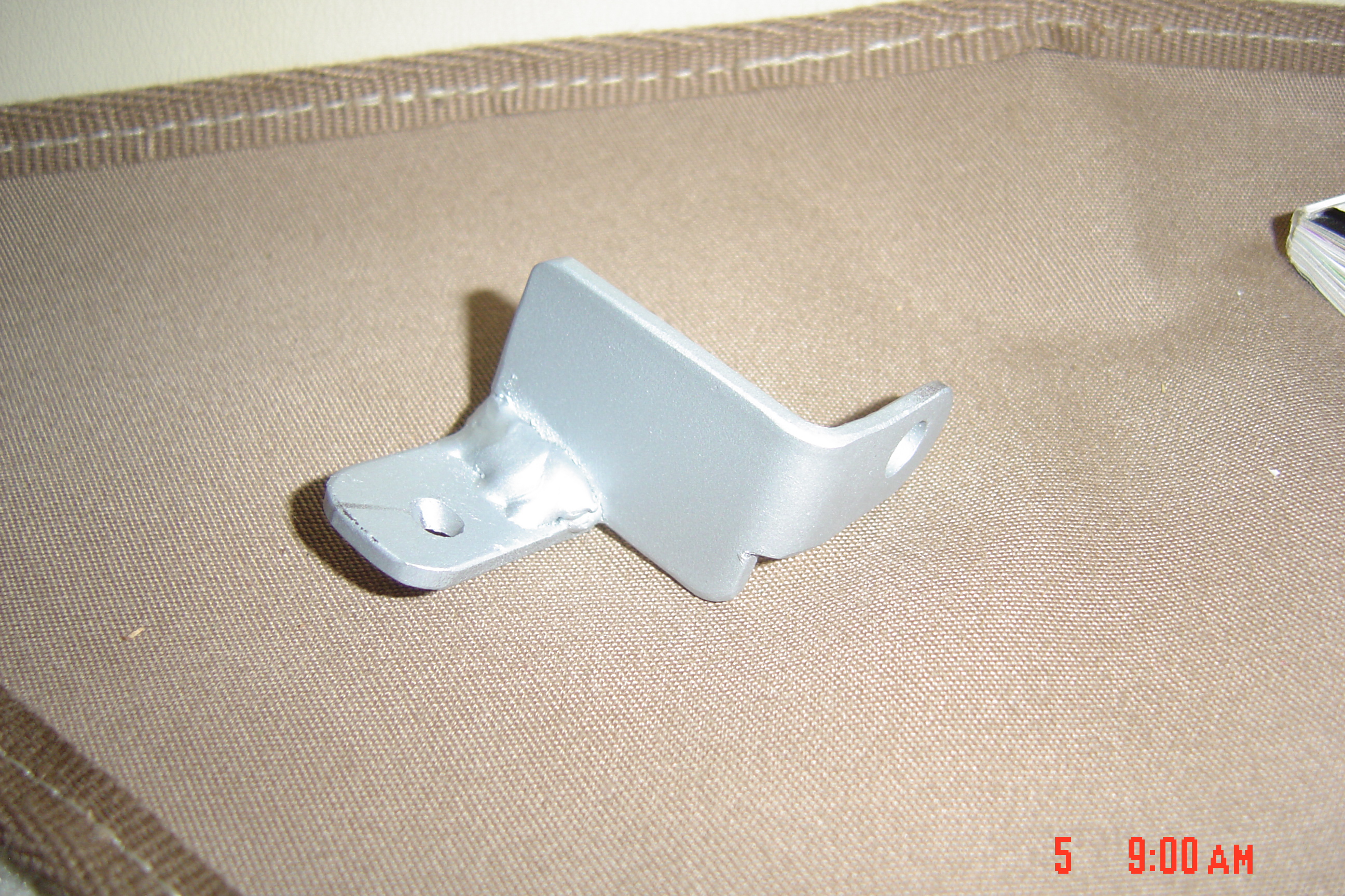

On your next photo-op can you give me a closeup of this lovely bracket: Now I went and did it... I rounded out the controversy by including the S-word in our R-word thread having already mentioned the M-word! Yikes! LOL david brady, '02 Wanderlodge LXi 'Smokey' (Sold), '04 Prevost H3 Vantare 'SpongeBob' "I don't like being wrong, but I really hate being right" |

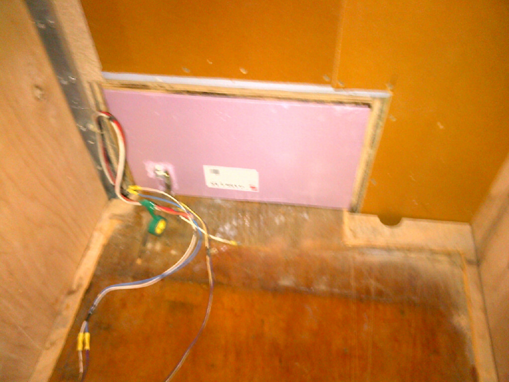

I guess I'm in a different situation, as my frig is on a 45 to the outside wall and has no vent in the wall. The air comes from a screen in the floor and has the conventional roof vent. To gain access to the rear of the frig, I have to take part of the bathroom wall out, remove about two dozen screws from a small access panel, and then I can see the back of it. If I ever want to remove it, I would also have to remove the commode so maybe I can reach far enough into the cavity, or use a sawsall to remove more wall.

(07-05-2013 10:51)davidmbrady Wrote: I don't think there's any question that the technology is sound. I find Tom's post very enlightening regarding the build quality and standards of the Dometic and Norcold absorption refrigerators. Folks who've replaced their cooling units with Amish units have reported improvements in quality. David, not sure this will work but I am trying to attach a picture of the bracket I made to attach the front corners. I did not use the level screws on the front of the new fridge so I had a good place to bolt the bracket to and I put a screw through the bracket into the wood cabinet. I may not put a bracket in the back as I stated before, think I will run it for awhile to see if it will be needed. I had the opportunity to take a good look at the 10 year old and the 5 year old cooling units that came out of my coach. My opinion is the quality of the material used to fabricate the cooling unit is substandard. I think I have pics of both units and if I can I will post them. David I think you will be shocked when you open your fridge up and take a look at the cooling unit. My guess is it is rusted to the point you will wonder how it worked. In the mean time you have small children so make sure the smoke detectors work. John |
