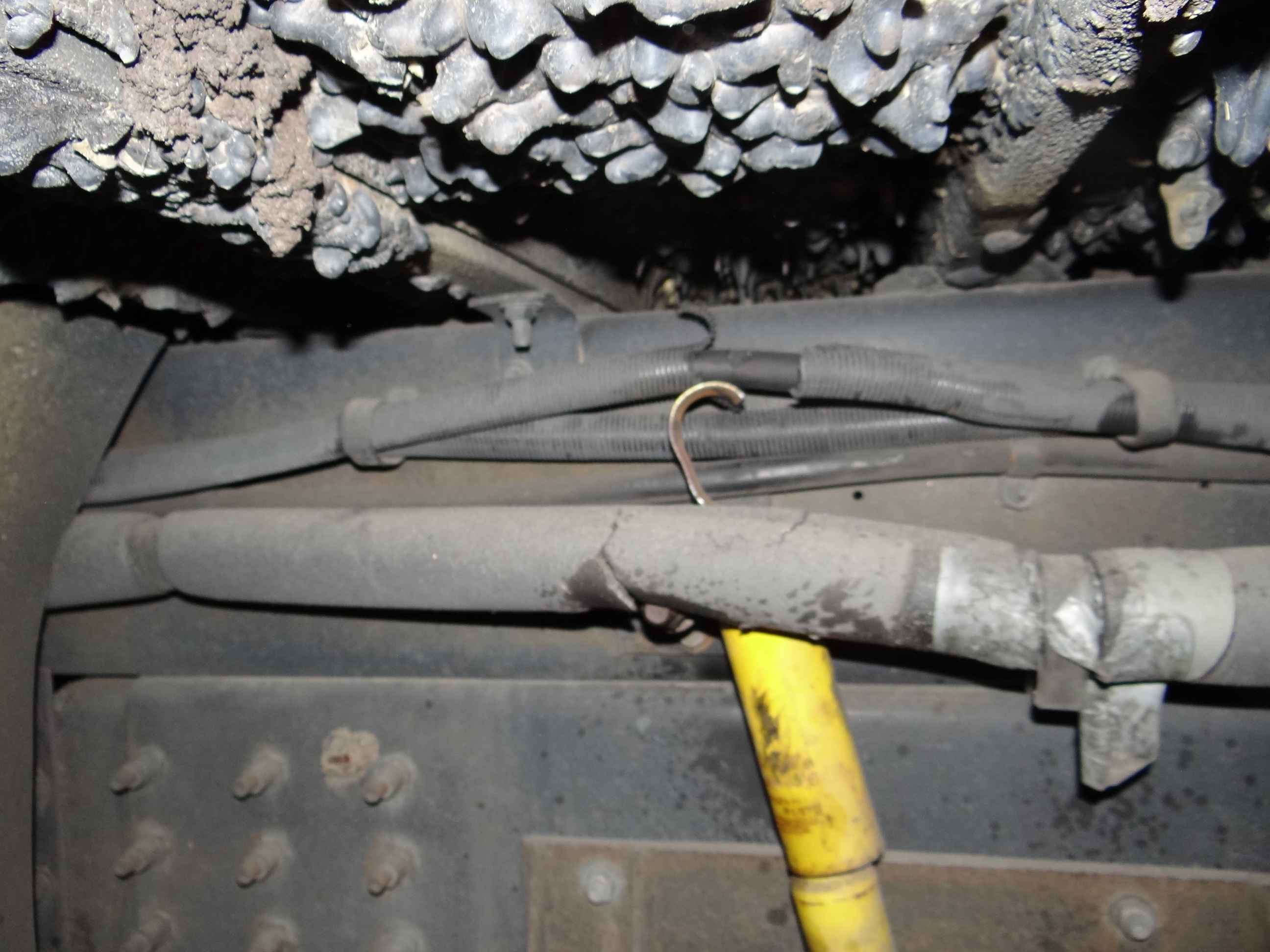

While Bim and I were installing the AGMs today, I was under the coach adding some zip ties to the cables. I had a good light and was looking at the tag axle shock. The centramatics were doing their job- this little gem was not.

my tire store removed the tag and shock. It is a Monroe and the replacement is on its way from Iowa. the mounting head of shock had broken. This was done a while ago as there was rust on the break. I was lucky in that it missed the aqua hot lines

got shock today and had my local tire store mount it. 66886 is the number. so far so good.
I tried to take the old one off but my old body over-ruled my mind. So for a total of 50 bucks, the tire guys removed tag, removed shock, mounted tag and then I came back today and they did the whole business again. best 50 bucks I have shelled out in a while.
