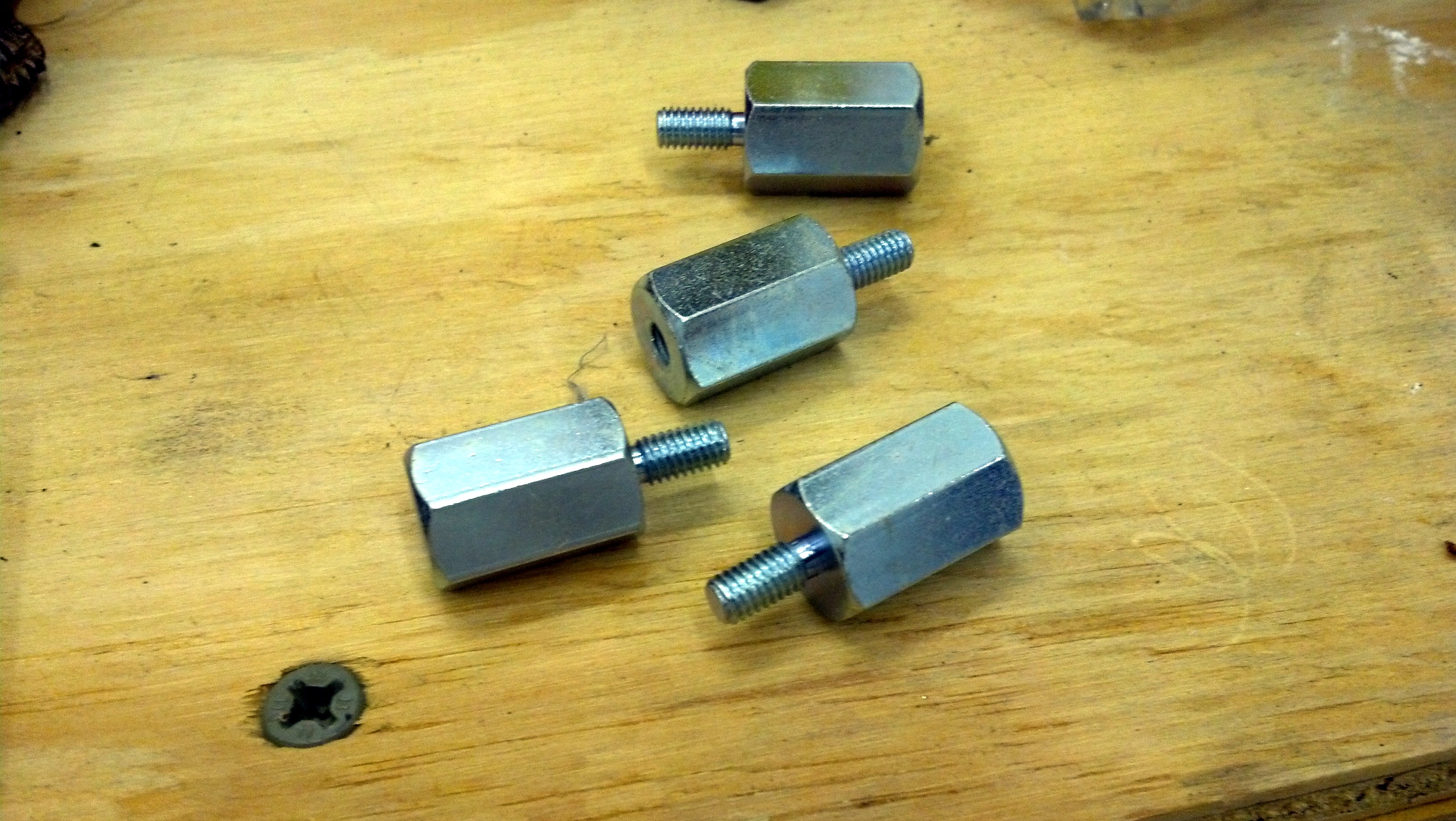

John, this stuff worked for me: http://www.shurtape.com/Default.aspx?Tab...roductID=3 but almost any HVAC tape will probably do. Experiment with a few. Remember, I had time on my hands
so I used these for standoffs, 10-32 thread screwed into rivnuts installed in the engine compartment ceiling. I have a profound dislike for sheet metal screws. ![]() david brady, '02 Wanderlodge LXi 'Smokey' (Sold), '04 Prevost H3 Vantare 'SpongeBob' "I don't like being wrong, but I really hate being right" |
