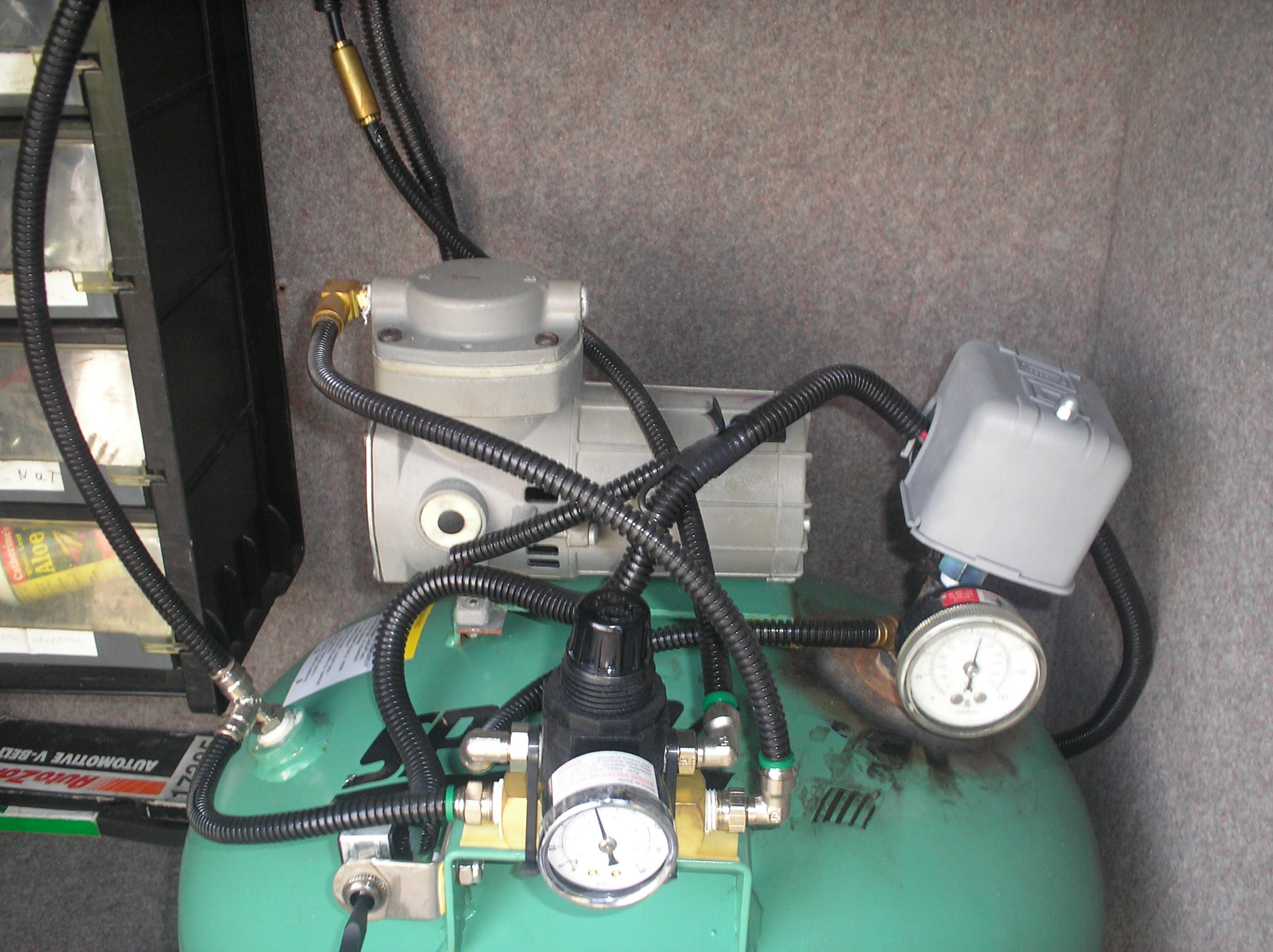

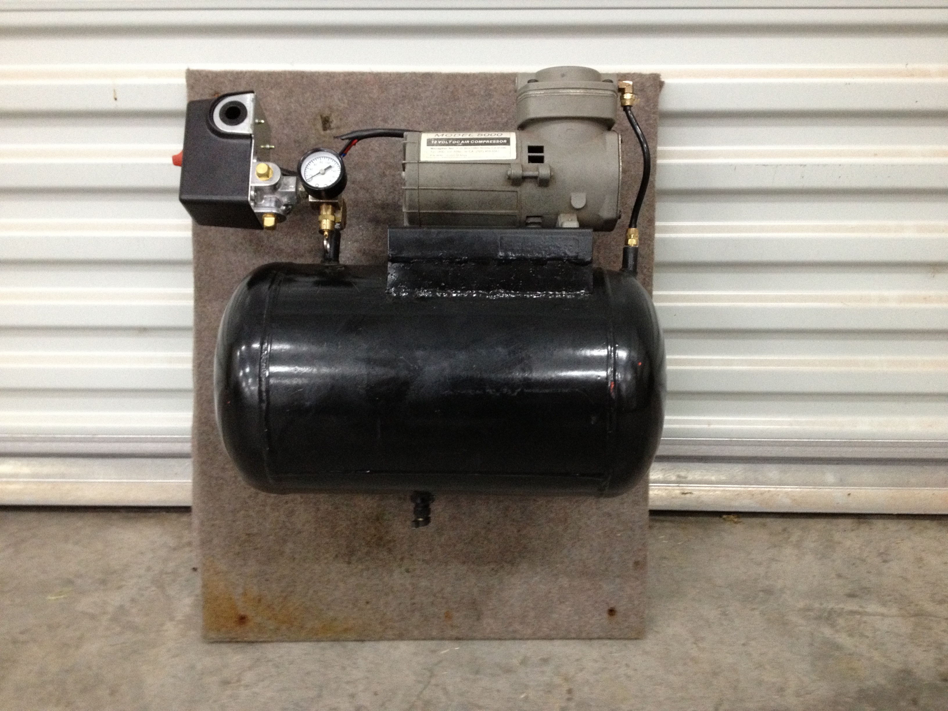

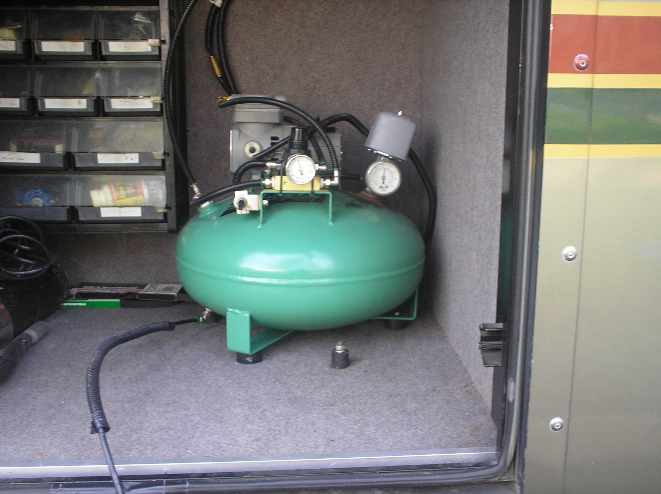

Here's my latest setup. This is one I bought out of a wrecked bird, but I actually had already started building this same setup. Even have the new tank already painted inside and out! But this was too good to pass up! It's a horrible freight sausage compressor tank with the Thomas pump mounted on the top. I'm currently holding 75psi over 48hrs with this set up. I installed my pressure cut off valve on it, as it has an on/off switch on it, so I can turn the pump off whenever I want to. I'm mounting this one right on the oem board from the old compressor with anble brackets to mount it upright, like the picture has it. It fits quite nicely right where the old tank was. If you can sneak up to Asheville next week, you're more than welcome to take a look. Funny, now that I've got 3 tanks and 3 pumps, this system will never fail! Of course, now looking at the posted picture, I realize I really should paint this one before I mount it!!! DOH, it's always something! John Mace 06 450LXi bigger bird living in the wild hinterlands of the north free to roam without the man getting me down  |

				(09-27-2013 20:39)Arcticdude Wrote: Tommy, Now that looks pretty cool and easy to get to without taking up a lot of floor space. When you say 3 tanks and 3 pumps, are they all installed, or just carry them as spares? Tommy Rountree, AKA RetDA Still a Newbie 1994 WB  |

					One set (the setup shown above) is installed. I've got the oem setup with slightly leaking tank sitting and then my partially finished sausage tank by itself and a third pump by itself. I only carry one setup in the bird. The others stay home.
