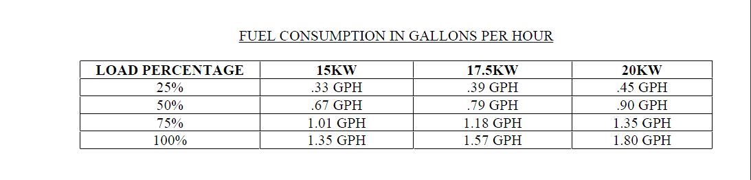

Here's some Powertech fuel consumption figures I gathered:
From the Yamaha manuals I've gathered a fuel tank of 4.5 gallons and a run-time at full load of 7.4 hours at rated output of 4KW and 15.2 hours at 50%:
7.4 hours at 4KW: 0.61 GPH
15.2 hours at 2KW: 0.30 GPH
Without doing a bunch of extrapolation, from the 15KW Powertech numbers we see that 0.33 GPH gives 3.75KW and 0.67 GPH gives 7.5KW. I think that it's safe to assume that at outputs of 2KW and 4KW the Powertech fuel consumption numbers would be even better.
