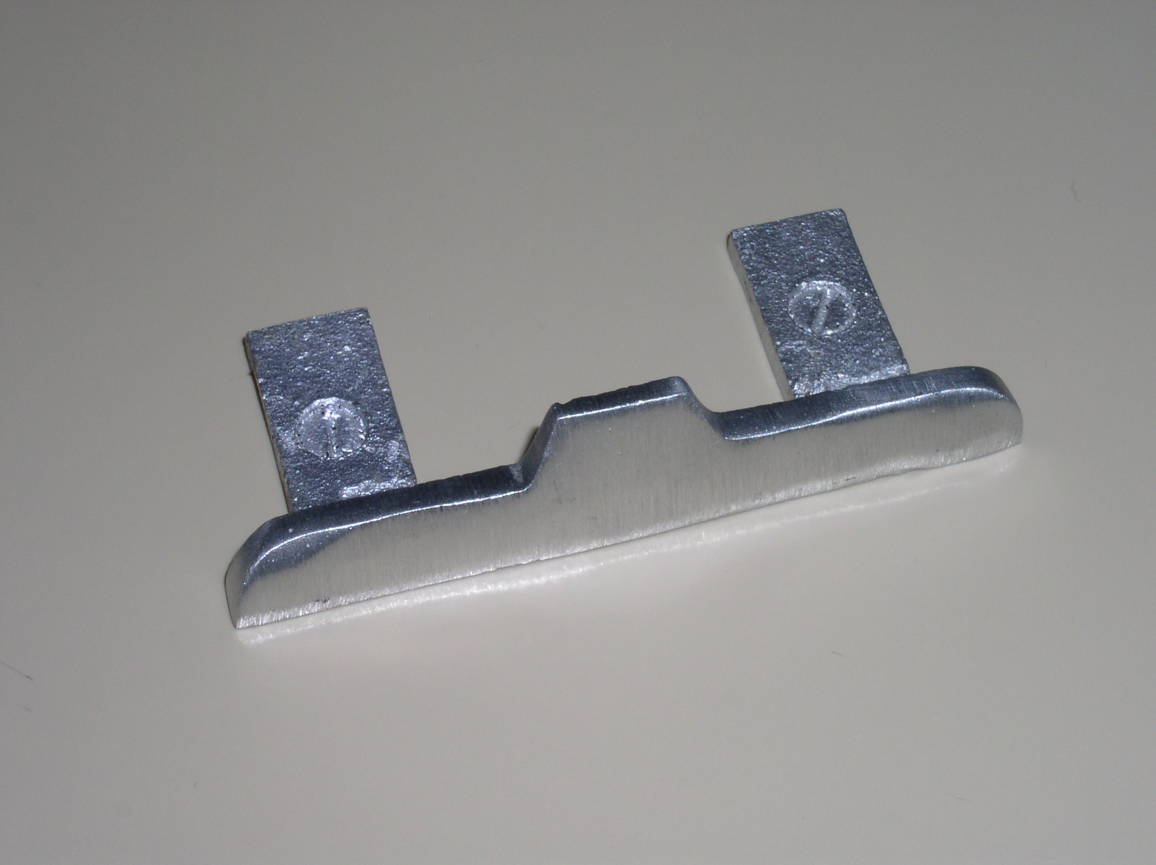

İmage Got the part. It has two tangs, both used when applied in the front of the bus, but only one used when applied in the rear of the bus because the hinged panel back there moves without the plug. The old tang is in place and impossible to remove, so it must be screwed on. I will have to cut off both tangs and glue it on. So, beware you don't break one of these plugs off.

Thanks Ron. It looks like the kind of stuff we used to make in high school shop class. So I take it there are no markings, numbers, or names on it?

So why not now make an epoxy copy of the part to use in your particular application, leaving the tang(s) off as needed? Glue that one into place, saving the oem for future usage. At least you'd have a perfect mould that way.

Did the original part break and fall off? Wondering if his is likely to be a common requirement for LXIs.
This does not look like it would be hard to fab up out of stainless or even mill out of aluminum. I have a full tool room with lathe, milling machine, plasma cutter, welders, etc.
A lost wax casting could also be made, and parts cast from the mould, although the metal might not be so strong as the original.

(12-11-2013 01:36)Arcticdude Wrote:  So why not now make an epoxy copy of the part to use in your particular application, leaving the tang(s) off as needed? Glue that one into place, saving the oem for future usage. At least you'd have a perfect mould that way.
Yeah, A mold would be helpful to other LXI owners since only 1 NOS is available right now, I truly like the dentist trick.........really cheap.........reminds me of making " candle wax molds" as a kid.......a lotta fun!Big Grin

Well, this part is not to the standards of those on the LXi. It must have been a cost reduction or a rejected part. It is a bit short and very rough, not rounded as on the bus. I'd carve a new one before making a mold of this one. I have reworked it as much as I can.

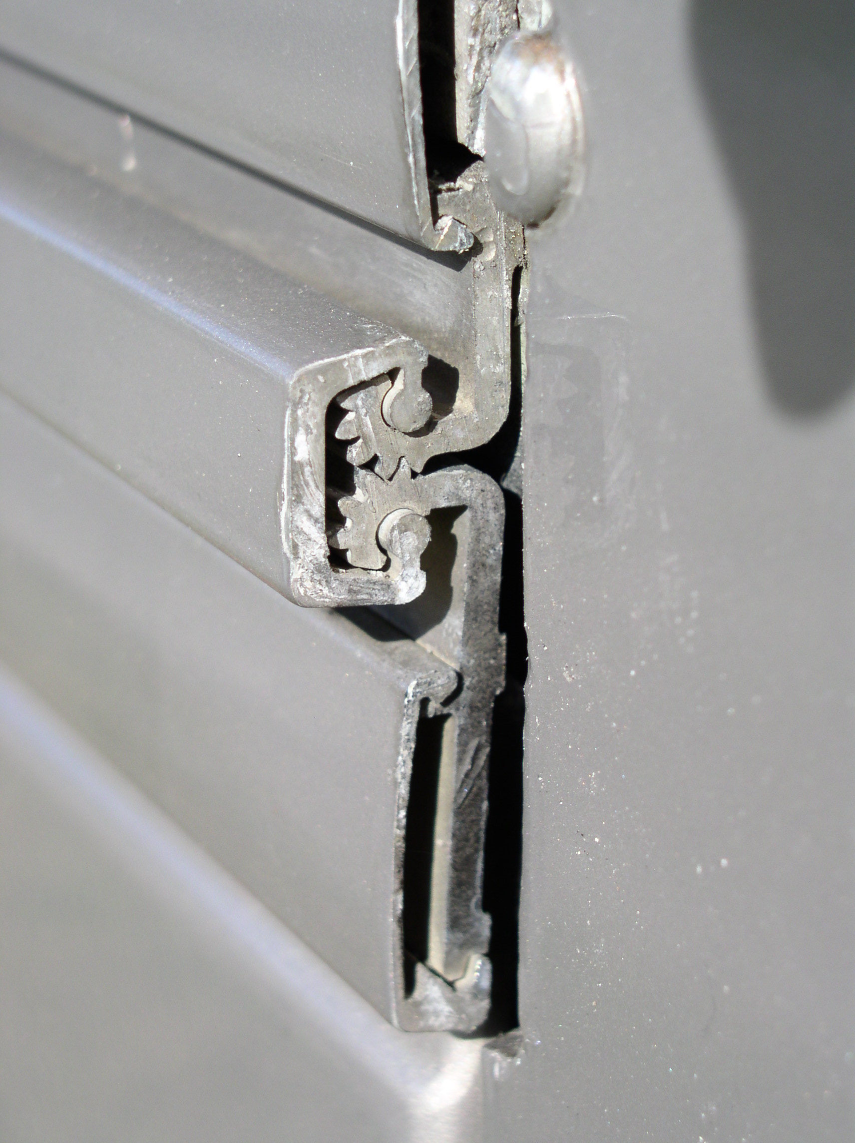

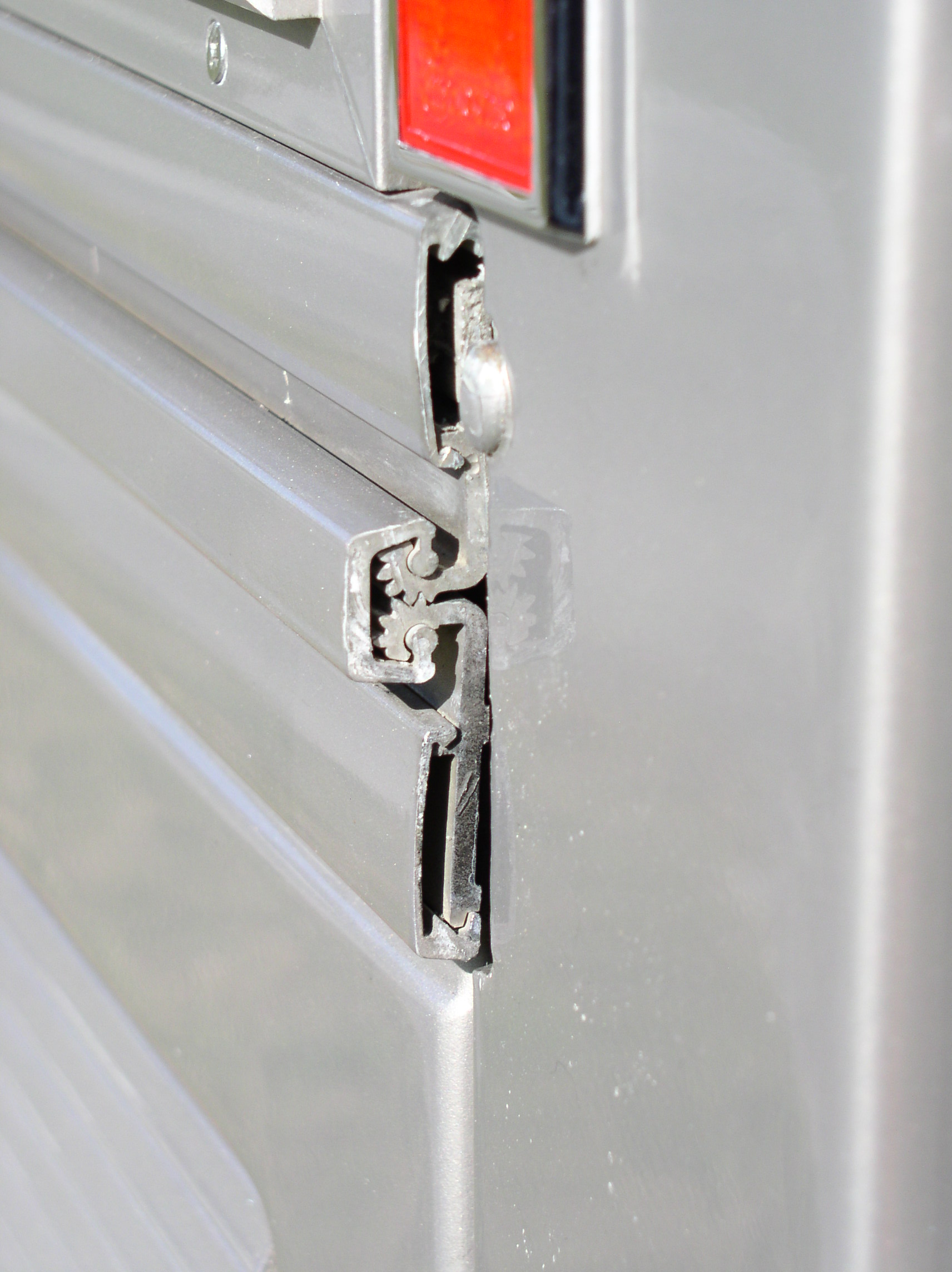

However, the more interesting observation is the hinge extrusions themselves. Blue Bird went to a lot of expense on that trim. Here are two pictures showing the exposed end. I had no idea they were extruded in the form of a gear so that the center piece would not favor one way or the other, but rotate evenly with the two adjoining pieces. Elegant. I like it. One of the hidden gems in these remarkable machines.
İmage İmage
