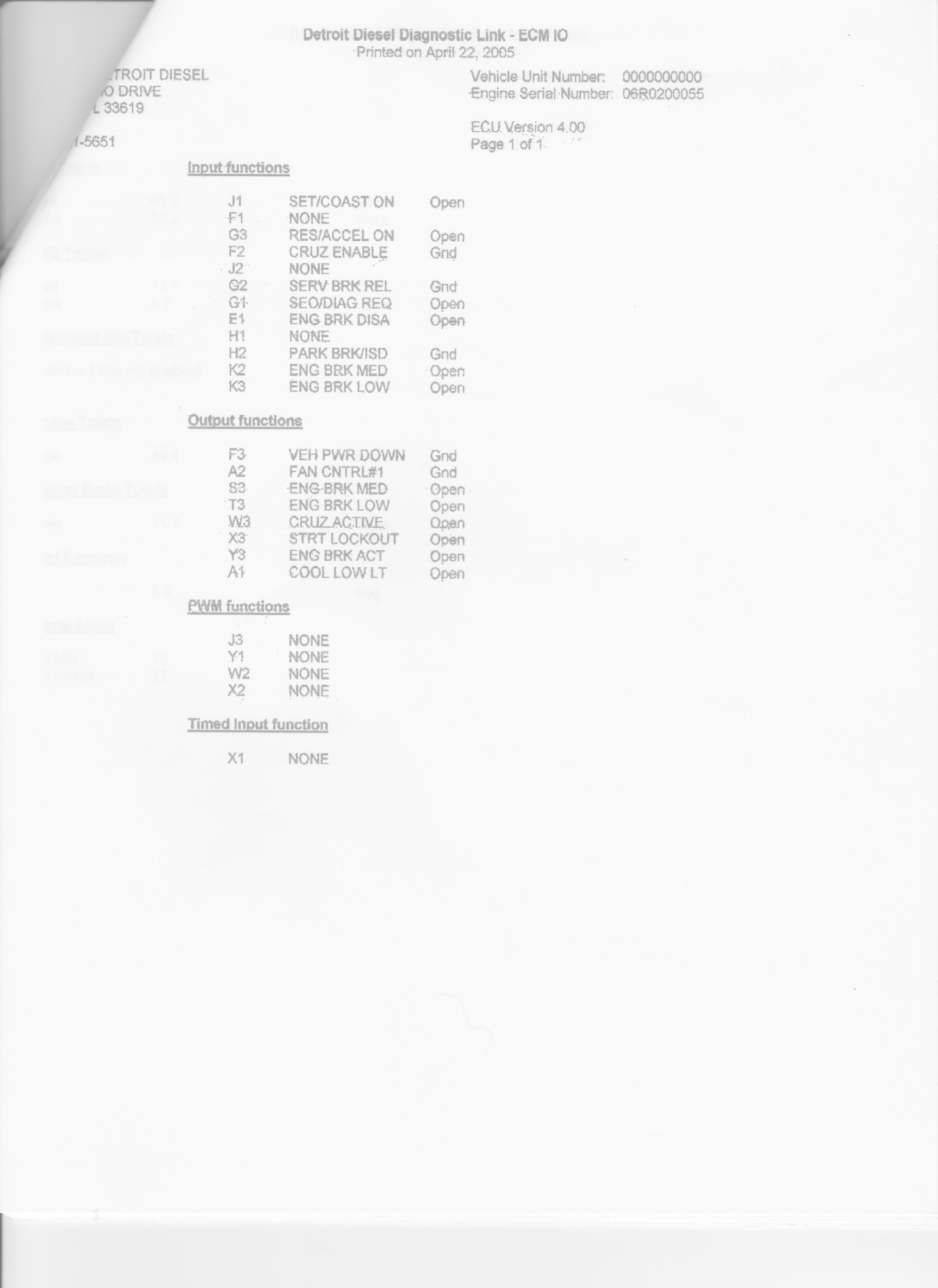

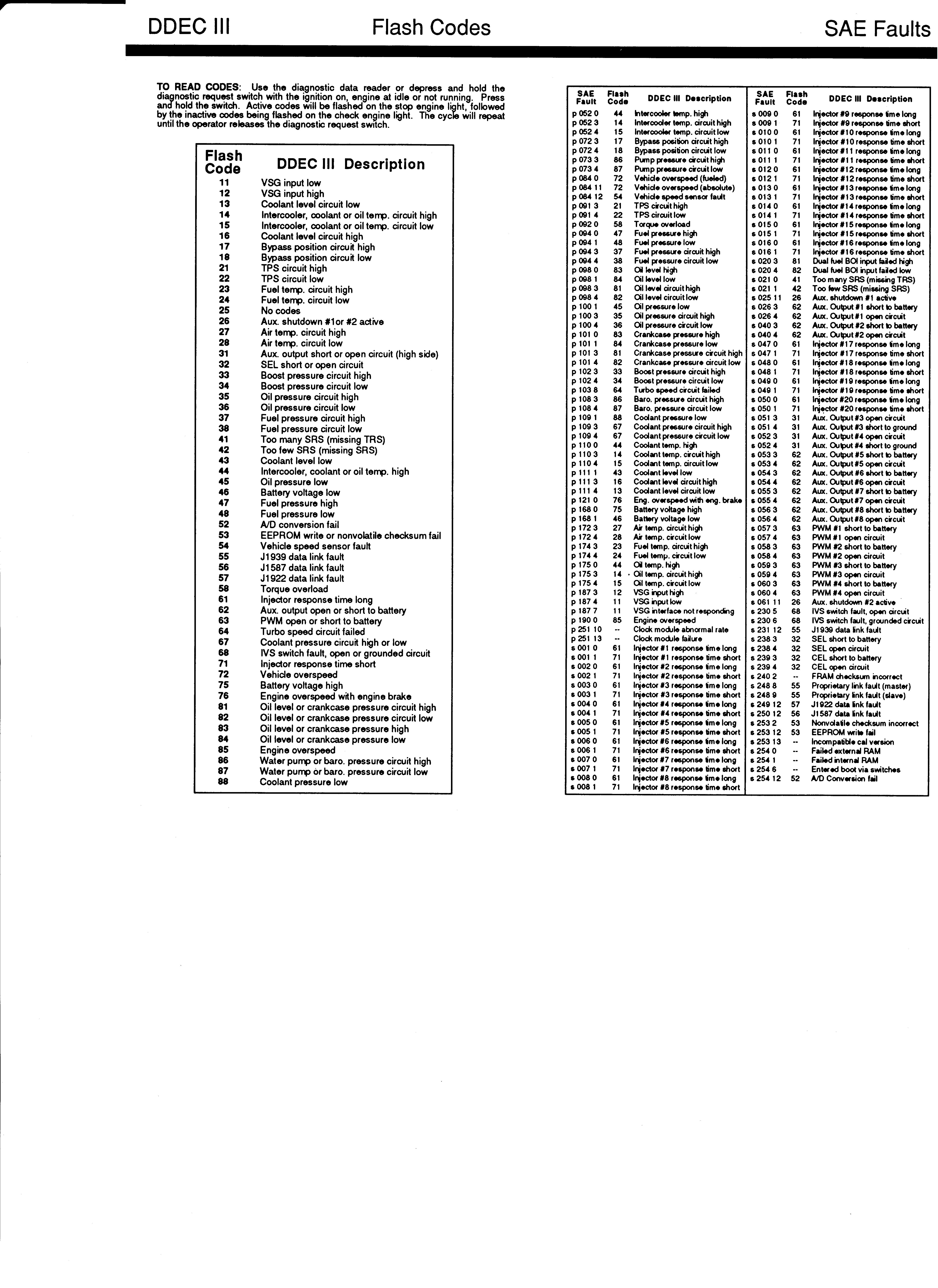

Thanks for the follow up.   Well, I did my homework so here is my "report" and some questions when you have a chance.The 95-97 s60's indeed used a DDECIII. 98 or somewhere there about and above appears to be DDECIV on all s60's in birds. I also have an optional Prodriver 18sp362. The ECU is running version 4.0 software level, rating version 11. ECM serial # sa60r6j1. I cannot find any references to "custom" Bluebird output in the diagnostic readout I have on the s60 so I presume if your beta testers were successful on this version of DDECIII software, it should work on our birds. I was going to wait until I can get to the bird, as it is in storage, and attach a picture of the connector, that will be forthcoming in the next week or two. Attached is the I/O page from my DECIII readout as well as the SAE fault codes they ship with our birds. I'm sure you have these, I just wanted you too see what they give us. ![]() Questions: - the issue you mentioned above about gear selection in DDEC III. Could it have anything to do with ECU software level / rating level? - will the application "behave" well with an navigation product running simultaneously on the IPAD? For purposes of this discussion you should assume the latest WIFI/CELL IPAD with 132GB of memory!   I want my copilot to be able to navigate and watch the gauges so she can pull a little travel stress of me, scanning analog gauges continuously and driving is getting a bit old after decades and I ain't gett'in any younger!  - Range, how far can I take the IPAD away from the CANPOD? I'd like to be able to be outside the bus at the rear observing the engine with the IPAD in my hand if at all possible. Yeah, I know, metal bus........ just wonder'in what your beta testers reported. Also, where do most of your users place the CANPOD? - I presume if we cannot get this thing to "hunt" on birds, you'll take the equipment back. I DO NOT plan on waiting to test try. If you are willing to do so, I'll just order it and give you a CC # next month when I get the IPAD. - My cell plan is up next month so all this will come together end of March when I order the new IPAD and associated personal infrastructure. ![]() I'll attach the connector here when I get a pic and keep ya updated. Thanks for all the data and looking forward to doing this. If we are successful, I'll volunteer to beta test any future versions you may decide to embark on since you've offered us a generous discount and are very easy to work with!   Thanks again!

					First, thank you for the images.  I will take a look, and see if my apps need updating.  A little technical info.  For the error codes, as per the SAE J1587 spec, I send a 00 message to the CAN bus, requesting data for PID 194.
			PID 194 is the error codes. The units respond either with 194 messages, or 192 messages (which is an overlength, multi-message response). In my experience so far, depending upon the DDEC, some respond with only engine error codes. Some respond with more. My bus, for example, responds with bus, brakes, instrument cluster and instrument cluster 2. If there are no errors, on my bus, these components report back with "no error" responses. I have never, unfortunately, seen in any of my error responses from testers an error from a transmission, either "no error" or any real error. I do get transmission messages, so I would hope that I would receive transmission based error codes. Quote:issue with gear selectionI assume it is ECU level related. The newer buses I've worked with generally have this message. Older ones do not. Quote:will it behave with navigation runningOne of my beta testers did indicate that he runs navigation apps in the background. However, I've never tested this way. One thing I've done in the app, perhaps a little non-standard, is that when you close the app, to go to another app, it does actually quit. I did this for a couple of reasons. (1) If for some reason the app got "hung up", I wanted a quit to clear it out of memory, such that restarting would start clean. (2) The data streaming by when you're not watching is not highly useful, in that there is no historic saving of the data, so if you're not watching, you're not seeing it. So, if your co-pilot is going to be using a navigation app at the same time, and going back and forth, the app simple restarts and starts streaming again when re-started. It takes about 2 seconds to get started and running. If you have an iPad or can borrow one, I would suggest testing first, even in your car. Put the RV Dash app in demo mode. That runs for about 3 minutes, but is identical in function to working with the CANpod. If you're able to flip back and forth, then I would feel pretty good. Only thing I would worry about beyond that is the fact that the CANpod woudl be adhoc to a wifi network, and your navigation would be via the cellular. I will talk to the beta tester I mentioned, and see what he does. Quote:range from canpodWith the antenna supplied, the range varies. I can easily step outside, but generally not back to the back of the bus. However, if I put the CANpod near the window, then the range is extended. The CANpod itself has a removable/changeable antenna. If you have a need to work at the back of the bus, perhaps a mag-mounted remote antenna would be better in that scenario? Quote:return if it can't huntSure, I wouldn't want you to be stuck with a piece of equipment that doesn't work for you, and makes you unhappy. This is why I would certainly prefer to test on someones vehicle first, if possible. I would suggest that for first Wanderlodge tester, I will send you a unit, but not charge your credit card. You pay for shipping to your site (as would be normal). If it works, I charge your card. If it doesn't, you return it, and I'll eat the shipping back. That way, I don't eat the credit card charges, in case of a return. I assume there's no chance you'll be in the Tacoma WA area in the next month? ![]() Ray  |

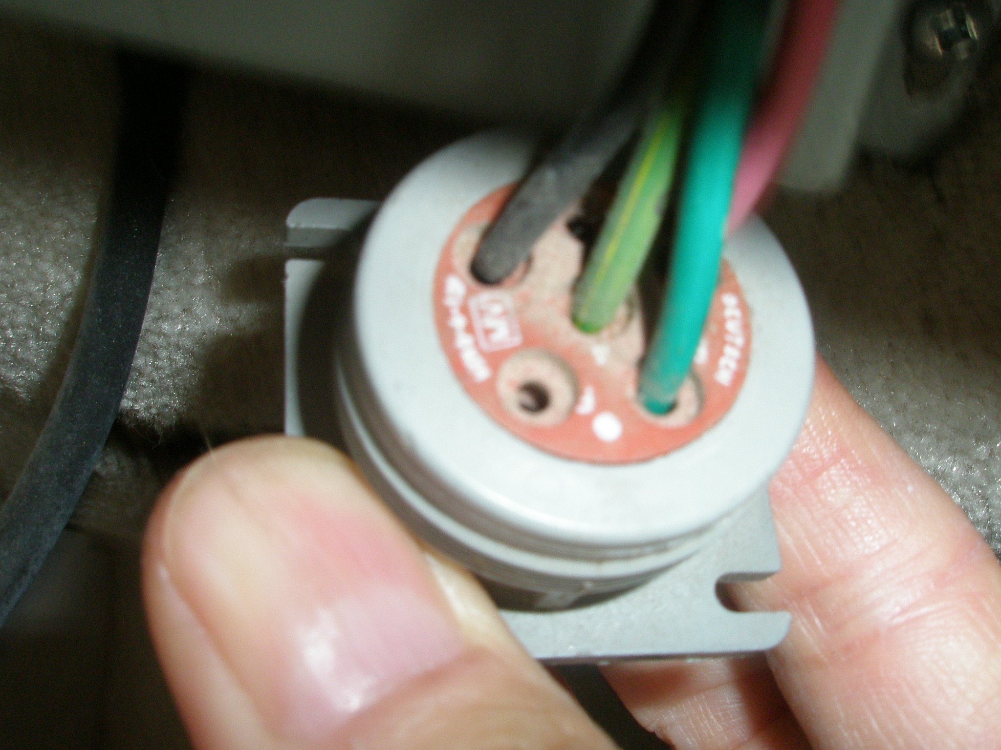

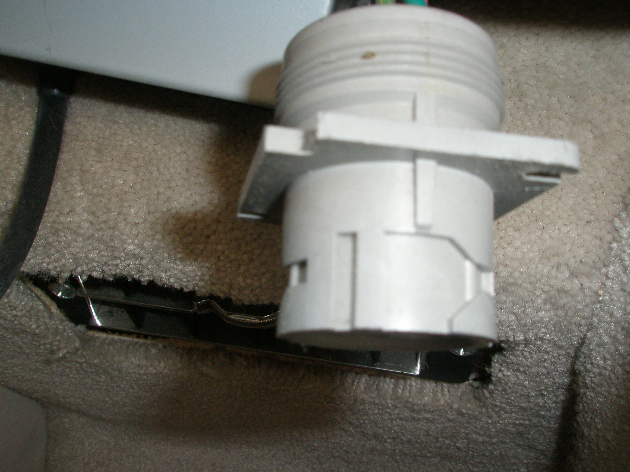

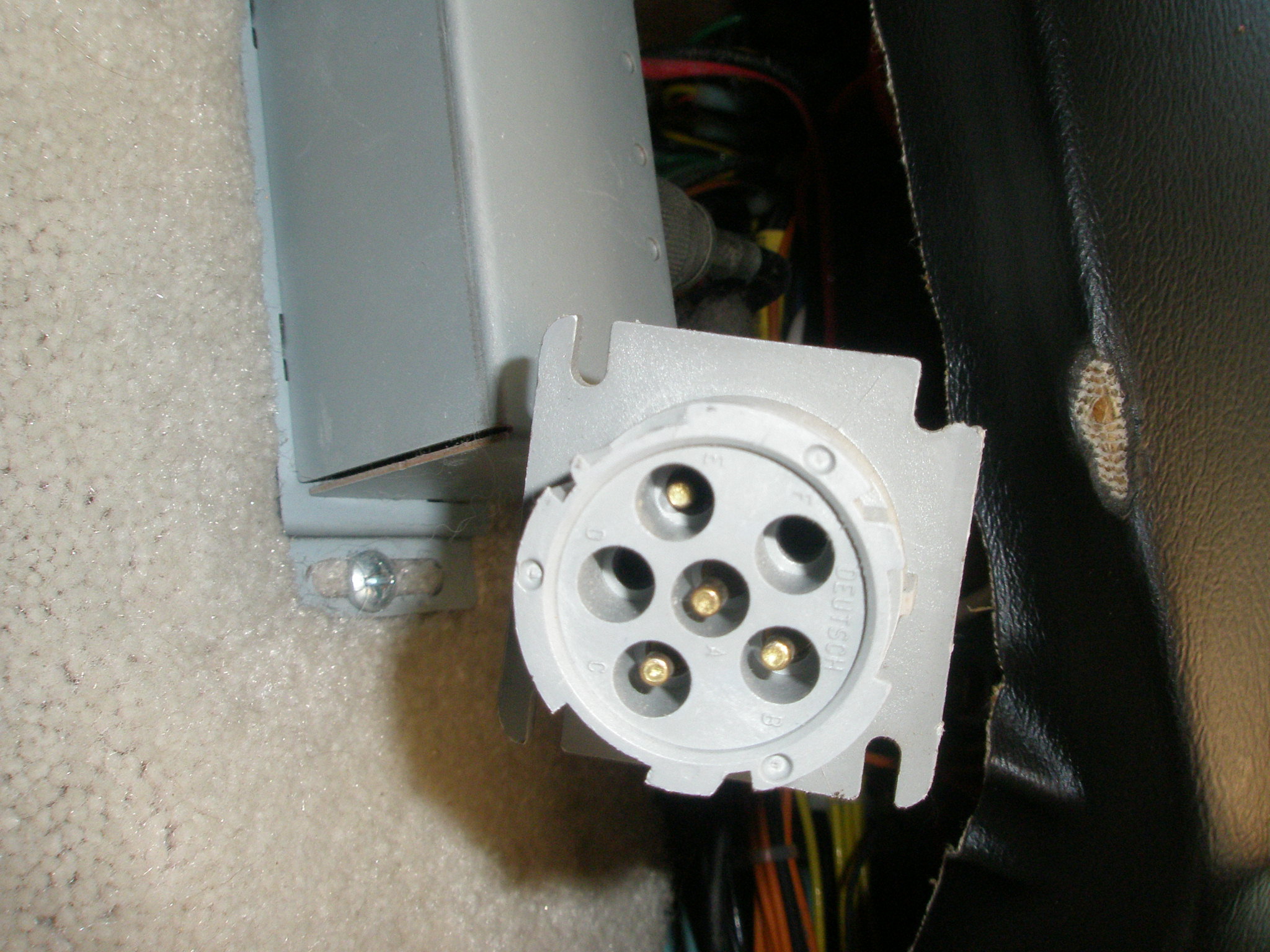

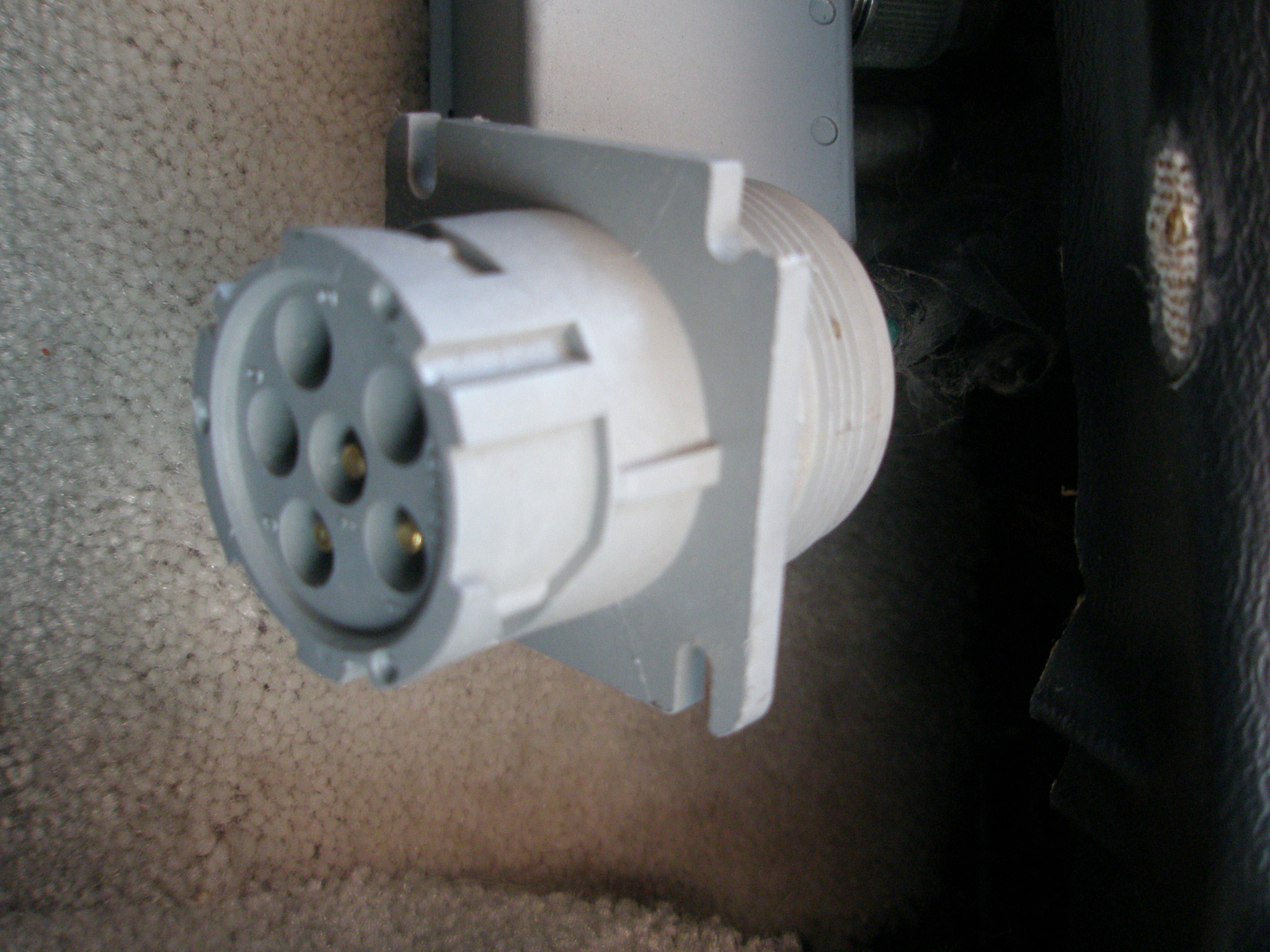

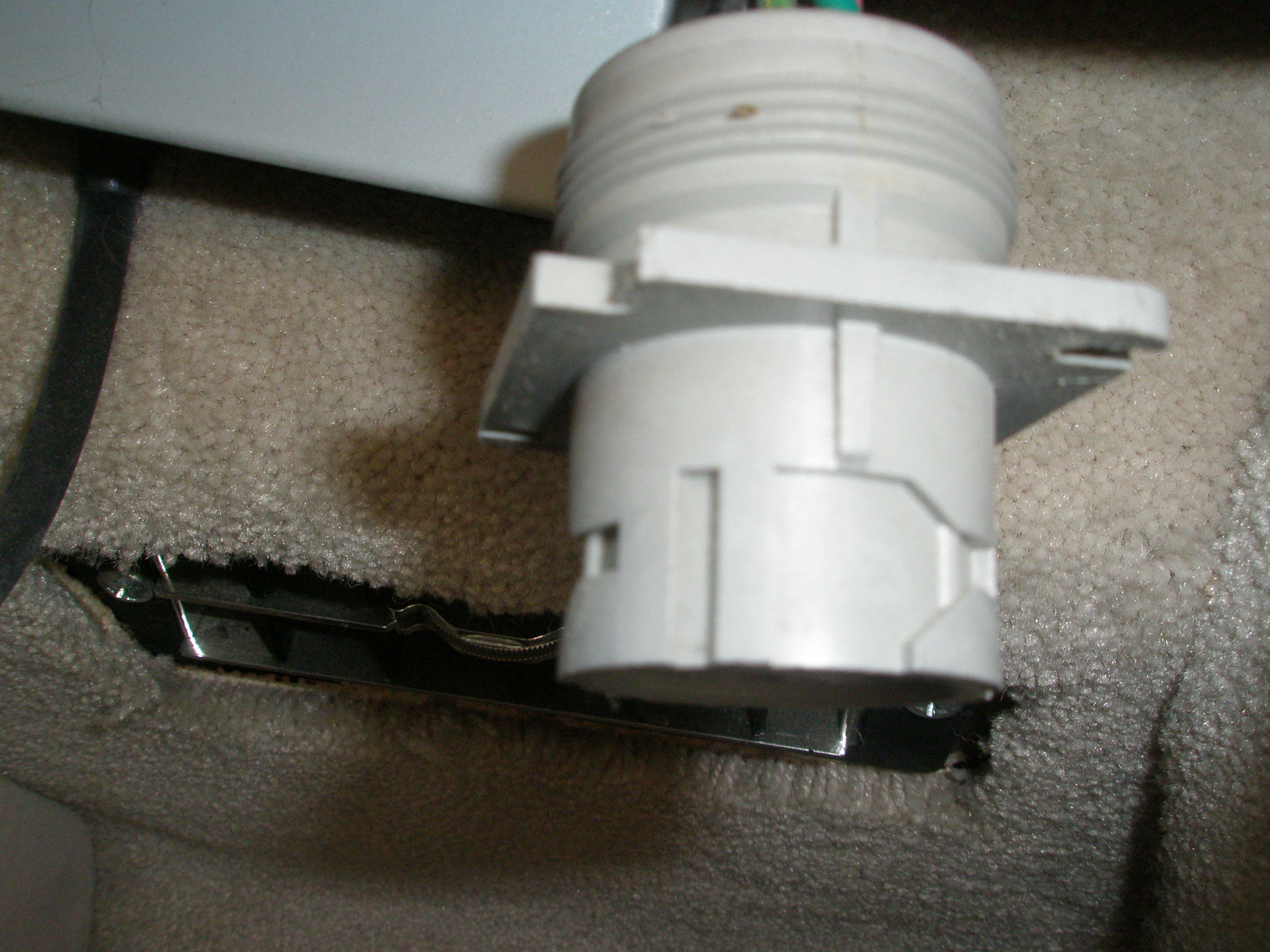

					Ray,
I was able to get to the bus yesterday so attached please find pictures of the connector. I also have a set of blueprints for the bird I obtained from the factory so here is the data: 1) It's a Deustch Diagnostic connector PN HD10-6-96P 2) Diagnostic Pins (4 wires used) B-goes to c1 on the ECM connector A- goes to c2 on the ECM connector C- goes to b3 on the ECM connector E- black ground goes to black ground in the power harness connector The prints also have an annotation noted saying that Diagnostic connector was a Detroit Diesel part # and harness DD part number ddc23513052. It appears they used a standard DD part so it should be the same as the Prevosts if they also used a standard DD part. I know that connector works as I have printouts from DD, 1 image I already attached above. However the ground pin appears to be more recessed than the other 3 pins in the diagnostic connector ( see pic 3). Is yours like that also? Thanks! Pete and Donna Chin 95 42' WLWB On The Road Always! :-) " We'll raise up our glasses against evil forces singing, Whiskey for my men, and beer for my horses!"-Toby Keith & Willie Nelson - The bridge from Toby Keith's title album track "beer for my horses"  |

					I am on the road right this minute, wife driving.  But off-hand that sounds perfect.  I will check it tonight or tomorrow when I arrive in WA and get back to you.
