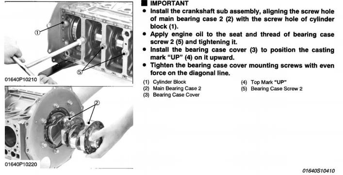

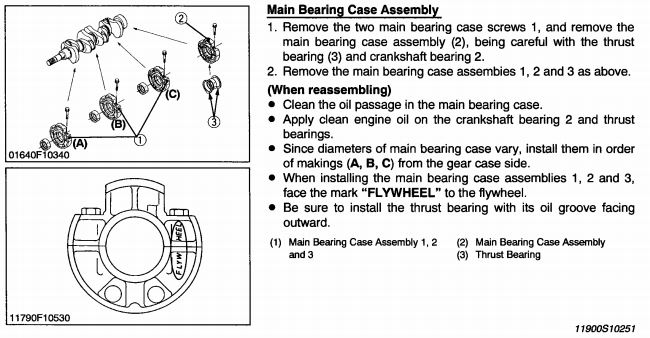

That's it Steve. Here are a couple of snippets from the engine service manual showing the main bearing assemblies. It's clearly a very stiff block. I'd like to know the tolerances of the bearing assembly fit to the engine block. The bolt coming up from the bottom cinches each assembly to the block. The manual says that each bearing cap assembly is of a slightly different diameter requiring that they be placed on the crankshaft in proper order. (Maybe a machinist here can shed some light on the tolerance of the fit).
