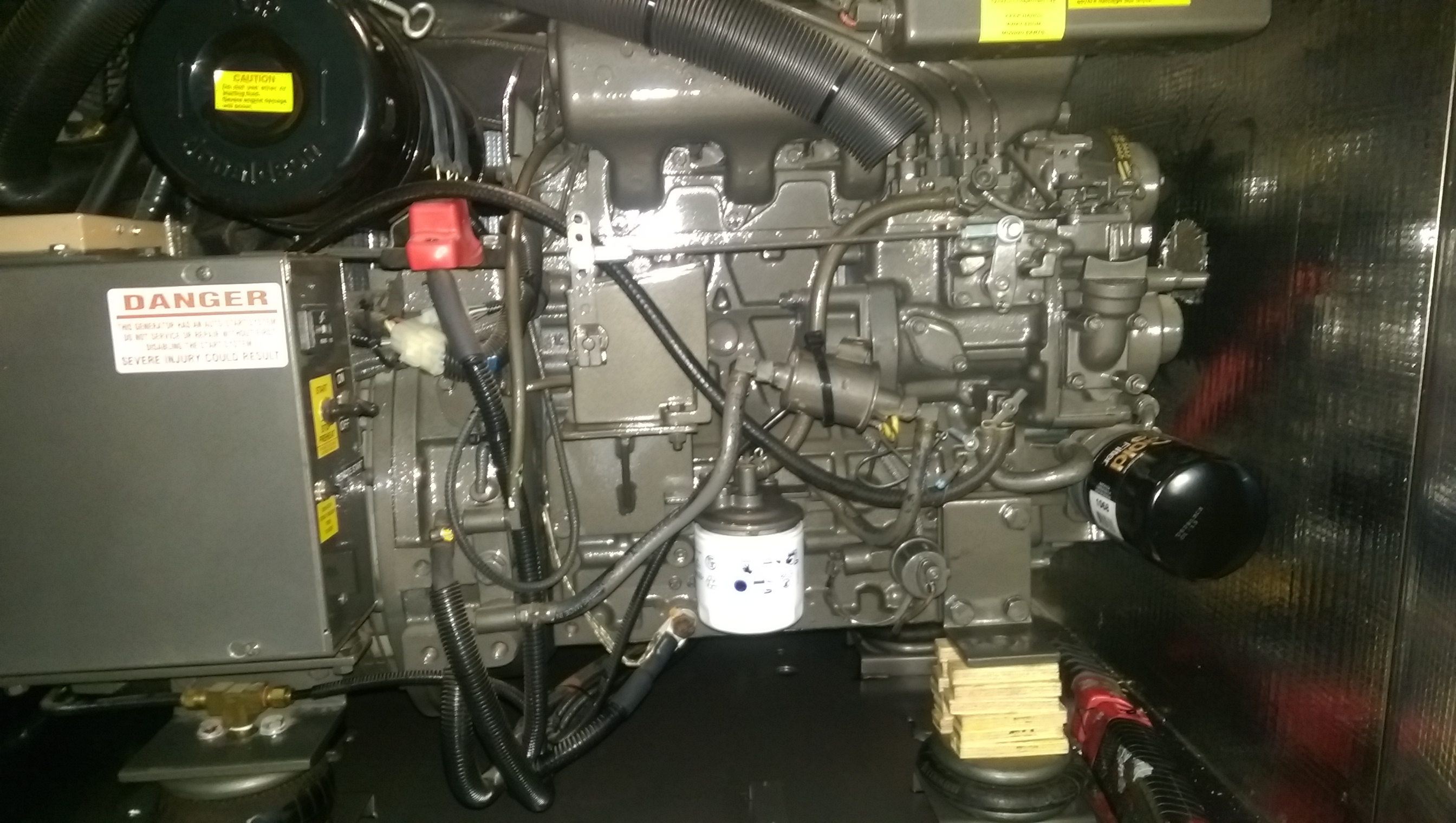

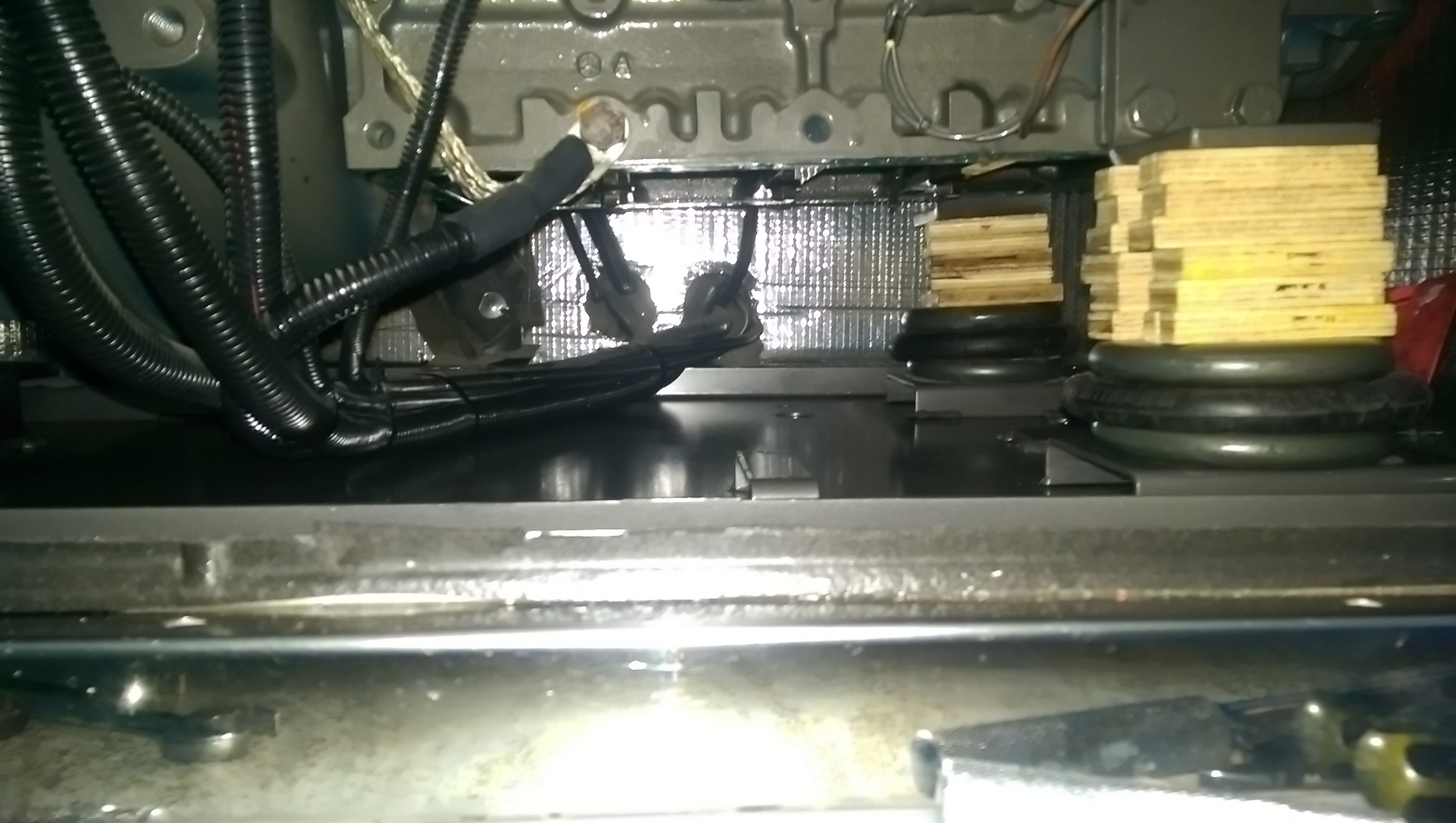

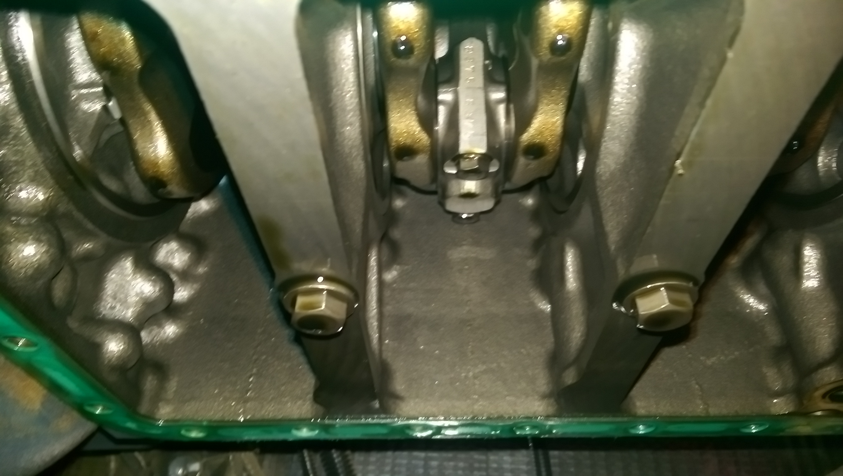

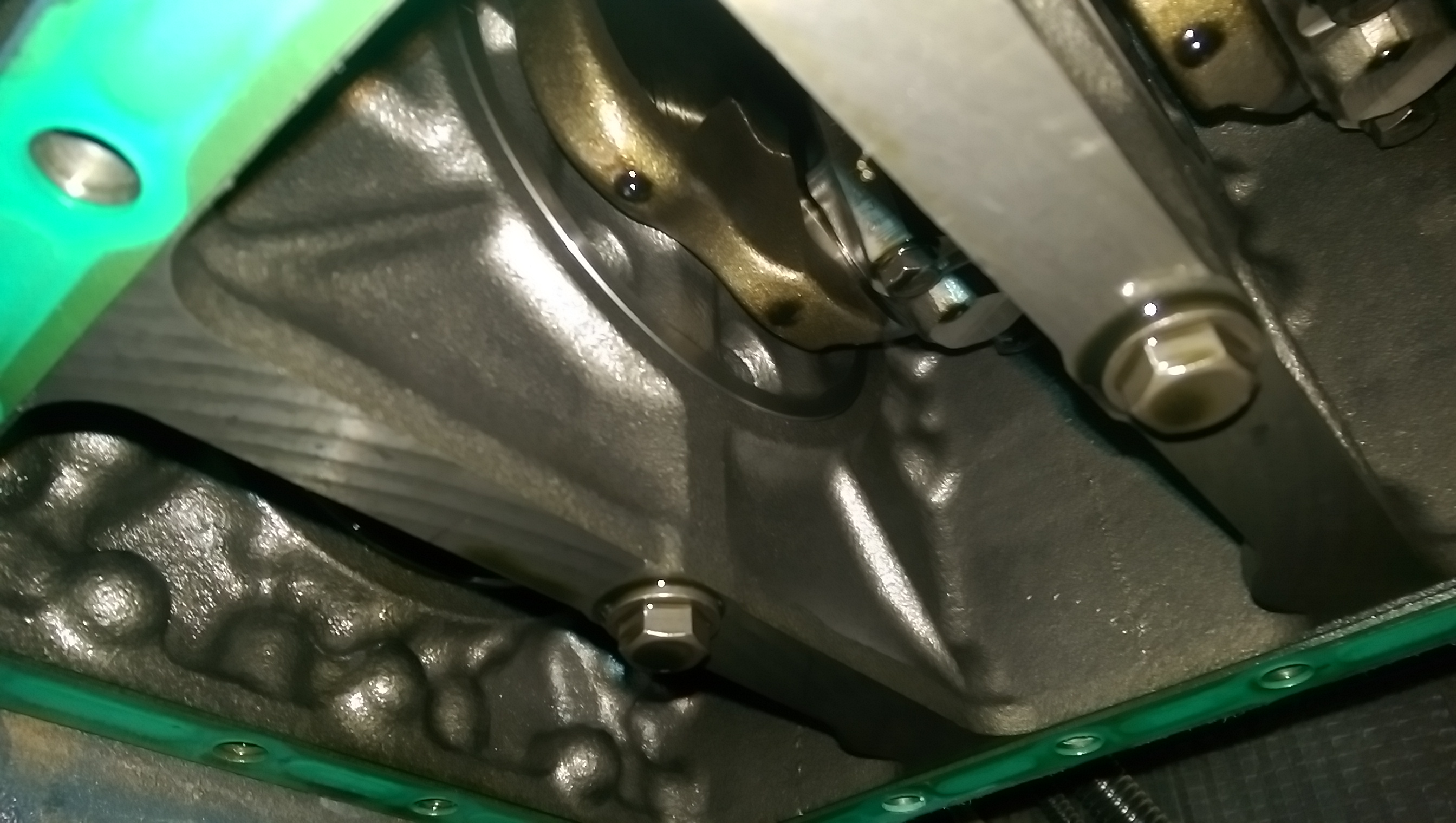

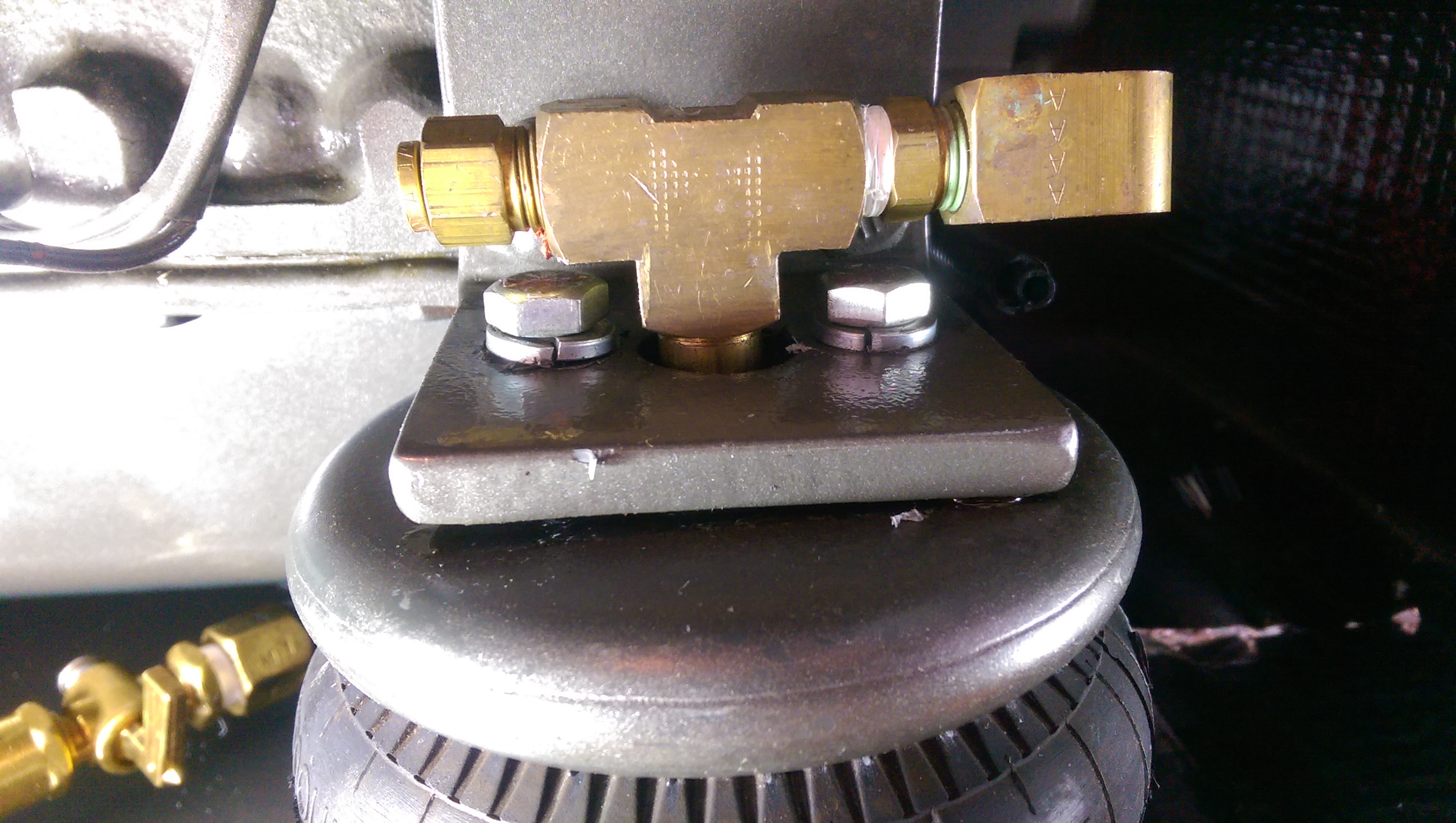

This past Friday I had a chance to give my MatJack 1 a try. I disconnected the fuel pump and tied it out of the way; I removed the air hoses and air fittings from the top of the air springs; I then removed the two top bolts releasing the air springs from the engine support mounts. I plumbed the MatJack 1 with air via a pressure regulator and slowly lifted the front of the Kubota. I then packed cribbing between the engine mounts and the air springs for support. This gave me enough room to reach around the backside of the kubota to release all the sump pan bolts. After unbolting the oil pump strainer the sump came right out:
QUIZ: Where are the main bearing caps? david brady, '02 Wanderlodge LXi 'Smokey' (Sold), '04 Prevost H3 Vantare 'SpongeBob' "I don't like being wrong, but I really hate being right" |
