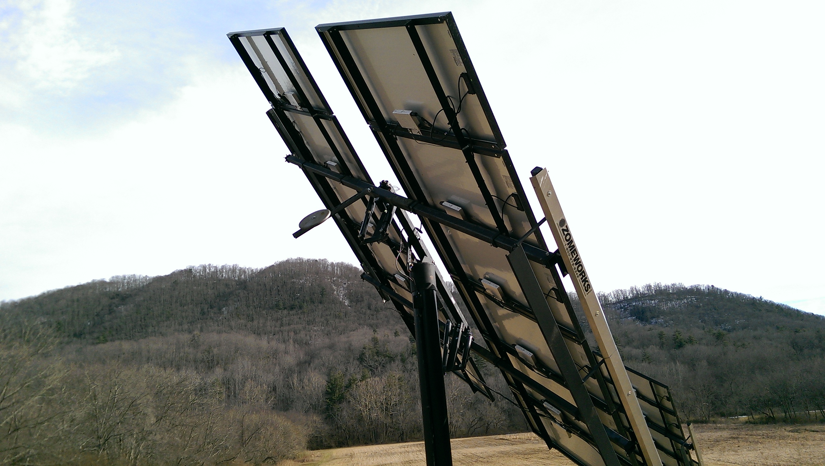

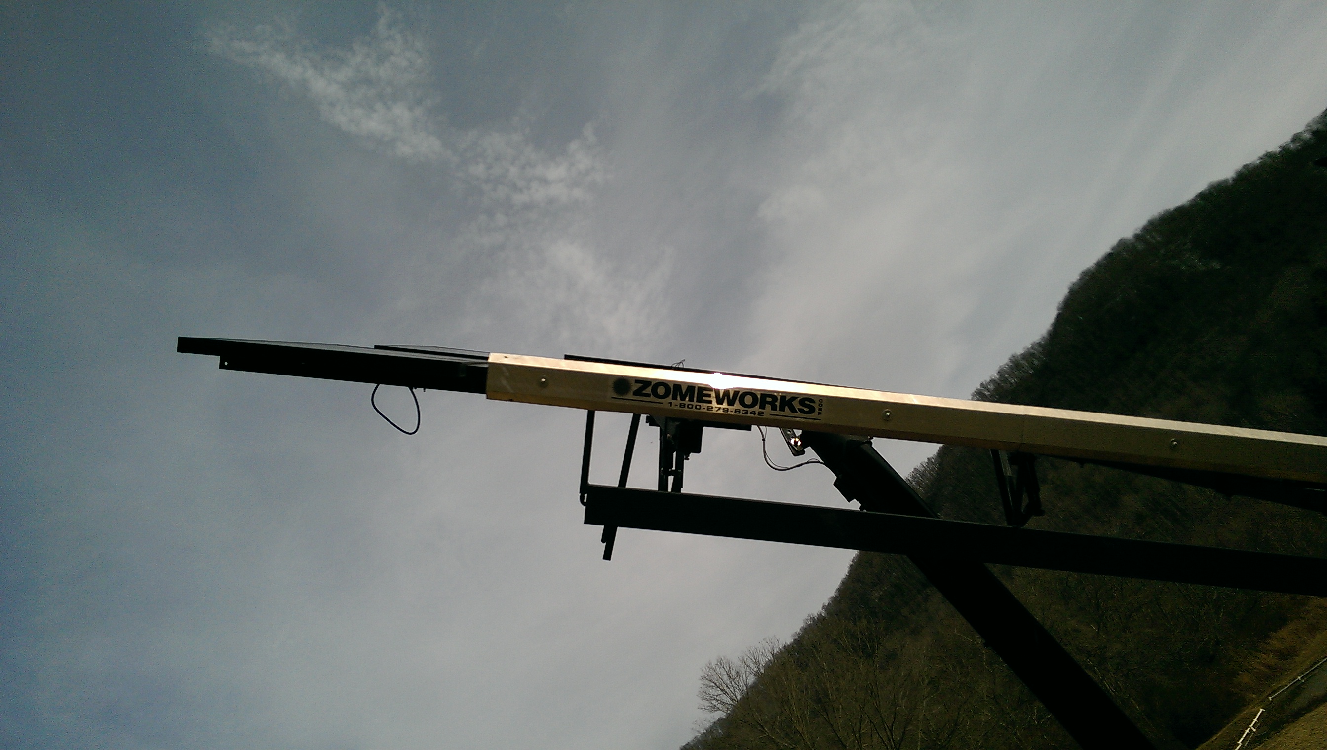

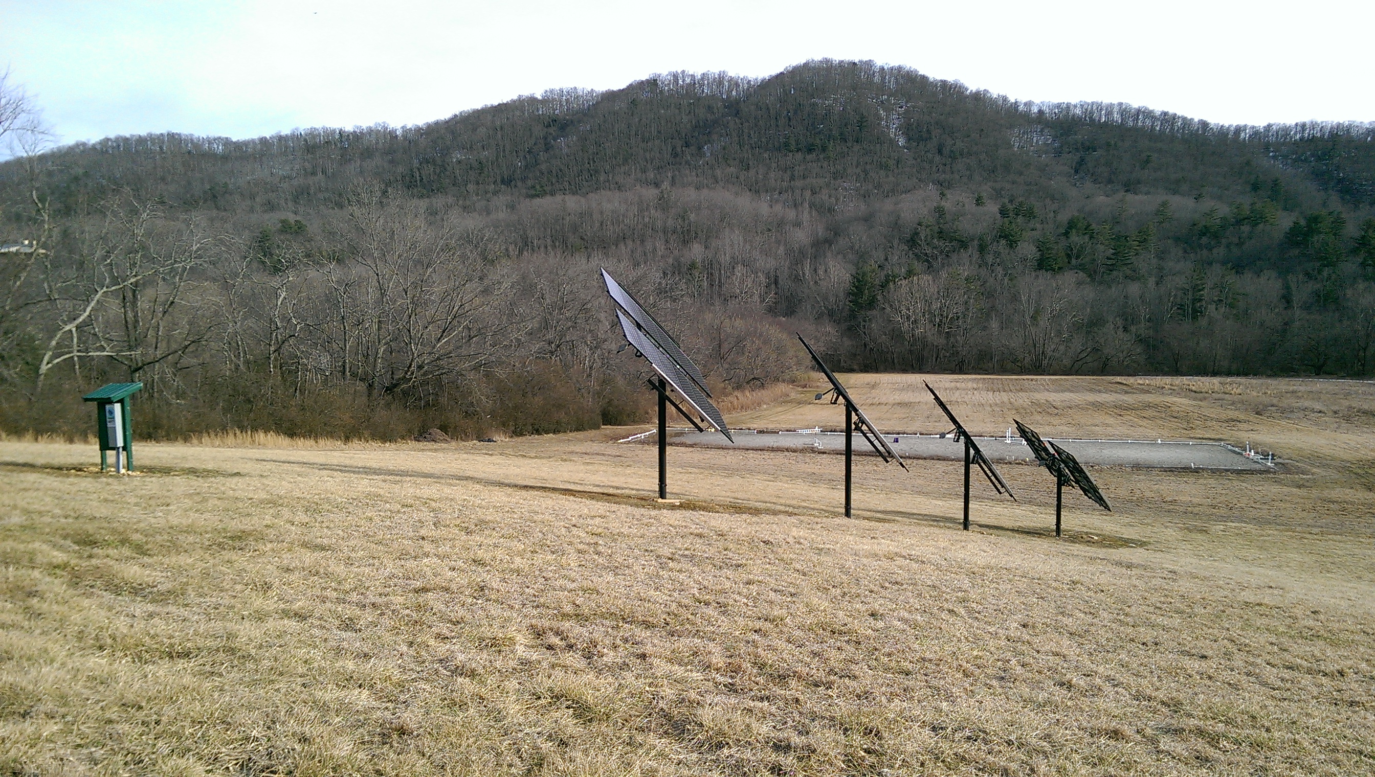

I've been thinking about installing a solar panel farm here at the house. My neighbor runs the Beatty Sun Farm, see pics below. He has 4 Zomeworks solar tracking racks, 10KW of solar panels, and 48 Enphase microinverters. He sells all the power generated back to the power station.
The Zomeworks racks use passive tracking. There's fluid in cylinders mounted to each side and piping going between the cylinders. As the fluid heats it's passively pumped to the other side which moves weight from side to side thereby tracking the sun, pretty cool. The price per rack is $2820.00 x 4 = $11,280.00.

The Beatty Sun Farm in Fletcher NC:
