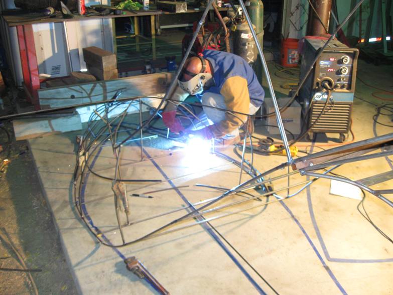

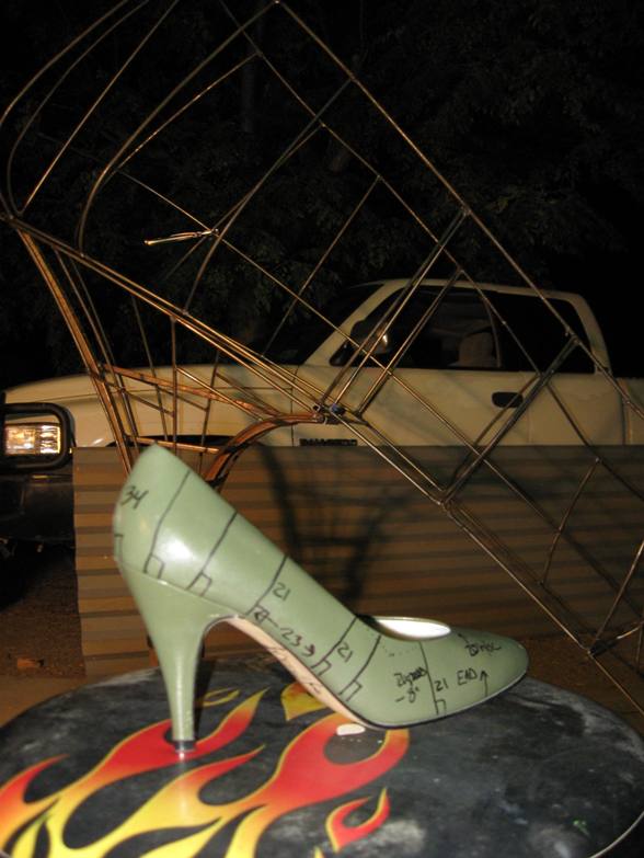

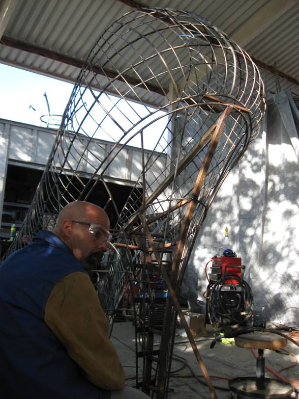

 -- Rob, Sue and Joey Robinson 94 WLWB Greg 's truck pit - gregory O - 10-16-2009 17:08 I'm gonna need some help soon trying to figure how to get the shoe on top of my bus. I have a 14 foot height limit for the parade at several locations . I built the shoe toe part to be under the limit but I need a way to fold the up arch and the heel. for now one thing at a time. I spent some time on the frame today no arch sole bending the opening slow progress. Tim checks every weld OMG I'm so Bald Scale of shoe model --- In WanderlodgeForum@yahoogroups.com, Rob Robinson > > Hahahah I love it Mario. > > 2009/10/16 mariopatti1 mariopatti1@... > > > > > > > Two heavy duty ramps over the pool should do it. Are stairs available?? > > Mario1985fc35 At Flying Fags > > > > > > > > > > -- > Rob, Sue and Joey Robinson > 94 WLWB > Greg 's truck pit - Donald Watson - 10-17-2009 04:08 Good Grief Greg! What an undertaking. Nice work. What’s the wire size? Great work scaling from the model shoe. How about using a couple of hinges, like tube and pin or bolt Chainfall for the vertical hike, eh? Is it that time of year for the ‘Pride’ parade? Is the Miller mig or tig? Regards, Donn From:   I'm gonna need some help soon trying to figure how to get the shoe on top of my bus. I have a 14 foot height limit for the parade at several locations . I built the shoe toe part to be under the limit but I need a way to fold the up arch and the heel. for now one thing at a time. I spent some time on the frame today no arch sole bending the opening slow progress. Tim checks every weld OMG I'm so Bald Scale of shoe model . Greg 's truck pit - Jqrjr - 10-17-2009 04:46 Lay it down on it's side Thanks Jim Riordan

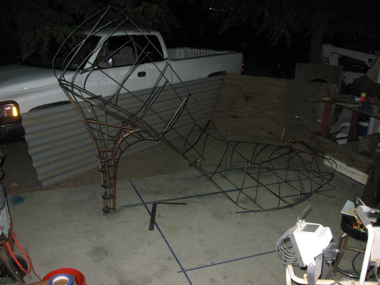

 Greg 's truck pit - gregory O - 10-18-2009 03:41 Lay on the side is a good option but I need to have it remotely raised and lowered to height several time during the event. in the movie Priscilla Queen of the Desert, that is how they stored the prop. the wire is 3/8 hot rolled for the shape. ( hot rolled bends to quick and I cant get a even curve, when you add some heat to cold rolled rod you can dictate the bend) problem with cold rolled is the rod wont flex as well to keep from cracking so after the shape was set I went to the less tensil strength cheaper hot rolled. I will build an interior frame with rectangle tube to reduce the flex and twist ( square tube gives movement resistance in two directions where rod and round is best to resist plumb gravity forces.) , I should have planned that and reduce the weight and wire size from the start ( next time I build a stilleto, I'll know) after the initial shape I reduce the wire size to keep the weight down. Miller is a Mig, I am a hack welder and have no idea how to Tig . I work with a stick welder on different metals , dirty buckets, and hardface to keep in practice. I need some sort of a hinge system and short of a skylight in the bedroom, I was thinking of cantelivering 2/3 of the prop off the back of the bus? that way I can transfer 2/3 the weight to the hitch??? Making the shoe fold out of shape would be an added perk as the shoe automatically takes shape parade side. We hope to set it up for events across the country for publicity , to promote our club, Rainbowrv.com. If this doesnt work I may look into building a weather balloon???? Greg of Tim&Greg 94ptca --- In WanderlodgeForum@yahoogroups.com, Jqrjr > > Lay it down on it's side > > Thanks > > Jim Riordan > > On Oct 17, 2009, at 12:08, "Donald Watson" dwatson@... wrote: > > Good Grief Greg! > > > > What an undertaking. Nice work. Whatââ¬â¢s the wire size? > > > > Great work scaling from the model shoe. > > > > How about using a couple of hinges, like tube and pin or bolt perpendicular to the wire? > > > > Chainfall for the vertical hike, eh? > > > > Is it that time of year for the ââ¬ËPrideââ¬â¢ parade? > > > > Is the Miller mig or tig? > > > > Regards, > > > > Donn > > > > > > From: WanderlodgeForum@yahoogroups.com [mailto:WanderlodgeForum@yahoogroups.com] On Behalf Of gregory O > Sent: Saturday, October 17, 2009 1:08 AM > To: WanderlodgeForum@yahoogroups.com > Subject: [WanderlodgeForum] Re: Greg 's truck pit > > > > > > I'm gonna need some help soon trying to figure how to get the shoe on top of my bus. I have a 14 foot height limit for the parade at several locations . I built the shoe toe part to be under the limit but I need a way to fold the up arch and the heel. for now one thing at a time. I spent some time on the frame today > > no arch sole > > bending the opening > > slow progress. Tim checks every weld > > OMG I'm so Bald > > Scale of shoe model > > > > . > Greg 's truck pit - gregory O - 10-21-2009 04:00 Tim and I had some time this weekend and worked on the shoe. We tried to attach wire mesh or screen to the metal frame for a foundation to hold spray insulation foam. the mesh idea was hard to deal with so we decided to add some 3/16 steel rod between the 3/8 inch rod for a better foundation for mesh wire. the result turned out to be more artistic than intended and we decided to scrap the foam process for the first parade and enter the shoe as a steel-etto. adding more 3/8 rod below is the frame with 3/16 rod added to the steel-etto the frame looked good as a steel structure but now we need to remove and rebend some structural 3/8 steel that is not up to par.Notice the strap steel that wrapped the outer heel was removed and I need to make the center 1x1 square tube pieces into a truss to hold the 3/5 of the shoe weight and strong enough to be a leaver for some fold up engineering I am thinking of doing with the 1x1 center square tube re welded up as a truss It now will hold me (175lbs LOL ) and some of the cage weight I needed to use a plasma cutter to remove the center heel supports and a torch to heat the cold rolled steel to add strength to the critical welds on the high carbon rod. > Greg 's truck pit - Joyce and Richard Hayden - 10-21-2009 04:43 Greg and Tim,

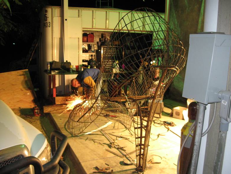

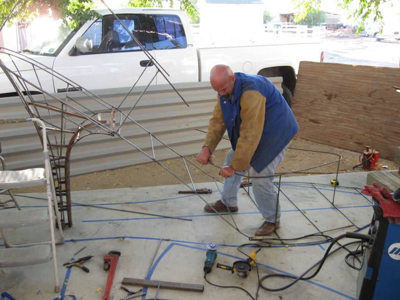

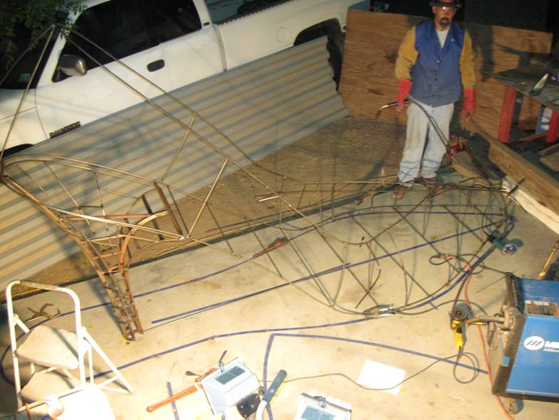

'86 PT-40 still working on the fuel problem inFt. Stockton TX Each time you judge yourself you break your heart. -Kirpal Venanji From: gregory O To: WanderlodgeForum@yahoogroups.com Sent: Wed, October 21, 2009 11:00:09 AM Subject: [WanderlodgeForum] Re: Greg 's truck pit Tim and I had some time this weekend and worked on the shoe. We tried to attach wire mesh or screen to the metal frame for a foundation to hold spray insulation foam. the mesh idea was hard to deal with so we decided to add some 3/16 steel rod between the 3/8 inch rod for a better foundation for mesh wire. the result turned out to be more artistic than intended and we decided to scrap the foam process for the first parade and enter the shoe as a steel-etto. adding more 3/8 rod below is the frame with 3/16 rod added to the steel-etto the frame looked good as a steel structure but now we need to remove and rebend some structural 3/8 steel that is not up to par.Notice the strap steel that wrapped the outer heel was removed and I need to make the center 1x1 square tube pieces into a truss to hold the 3/5 of the shoe weight and strong enough to be a leaver for some fold up engineering I am thinking of doing with the 1x1 center square tube re welded up as a truss It now will hold me (175lbs LOL ) and some of the cage weight I needed to use a plasma cutter to remove the center heel supports and a torch to heat the cold rolled steel to add strength to the critical welds on the high carbon rod. >  |
